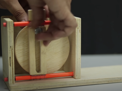

Next, on a piece of plywood, create a circle that is 10 cm in diameter and a strip that is 15 cm by 3.5 cm, as seen in image 5. Then, using a wood cutting saw, cut the plywood along the drawn line. You now have two plywood pieces, as shown in the last image.
Step 3: Try Out Mechanism
Now drill a 10 mm hole in one corner of 10 cm of circle plywood and place a wooden strip on it. Using the M10 bolt, try to fix and disassemble after a tryout.

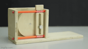

Step 4: Make Slider of Wooden Strip
Now, take that piece of plywood and cut it into two pieces as seen in the first image. Then cut off both sides of a 2.5 ml syringe. Get a cylinder of plastic now, and attach it to the plywood strip on both sides.
Next, take a short piece of plywood and attach it to the side of the syringe cylinder.

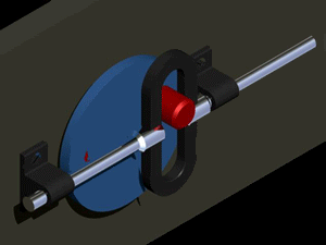

Step 5: Mechanism to Translate Rotation Into Reciprocating Horizontal Movement
Now attach a circle of plywood with a 10 cm diameter to a dc motor shaft. Next, take two pensils and pass them from the syringe like slider as shown in image 5. M10 bolt is then fixed via the wooden strip.

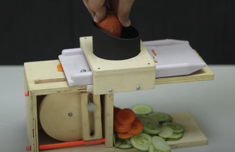

Step 7: Top Platform
Making a platform for the sliced vegetables is now necessary. Draw rectangles like those in figure 1 on a piece of plywood that is 28 cm by 10 cm. Then use a wood cutting saw to cut this section. Fix this plywood to the vegetable cutter after that. Then attach two little wooden strips as seen in the last image to allow the veggie slicer to slide.

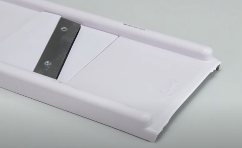

Step 8: Fix Vegetable Slicer
Take a ready-made manual vegetable slicer, then cut the handle as shown in image 2. Fix this vegetable slicer to a wooden strip top that moves horizontally after that. With this equipment, a variety of cutting blades are available.

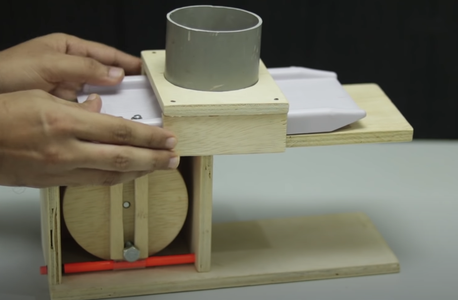

Step 9: Vegetable Hole
Now cut a 10 cm long piece of 6 cm dia. pipe. Next, cut a 6 cm hole for the pipe in a piece of 10 cm by 8 cm plywood. In the third figure, attach the pipe to the wooden piece and the other two wooden strips. After that, set this structure on the vegetable slicer.

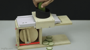

Automatic vegetable slicer is now Ready to Work.
Step 10: Practical
Now, turn on the machine and try to cut the cucumber, onion, and carrot.
