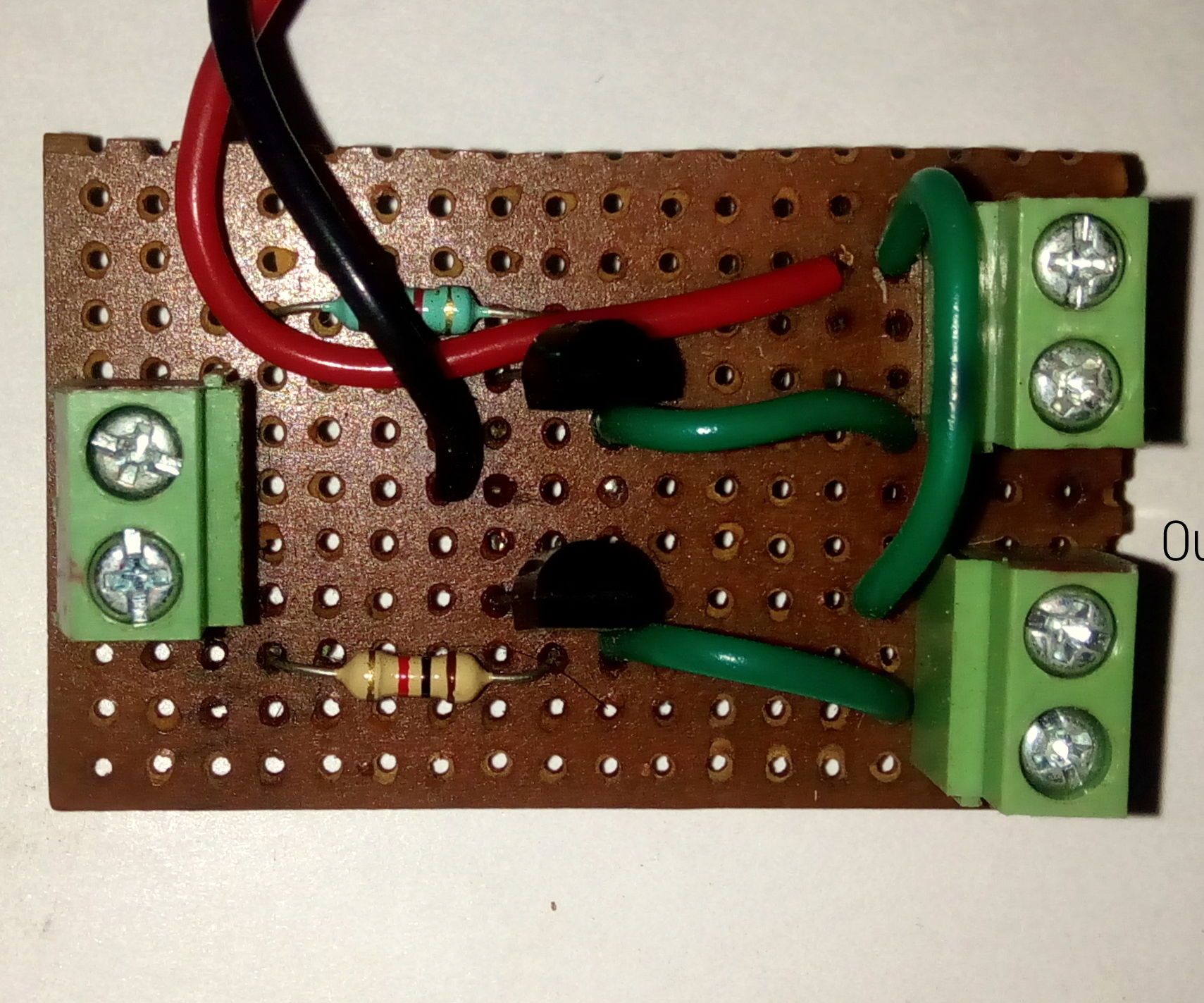

This simple transistor based water level controller circuit is very useful to indicate the water levels in a tank. Whenever tank gets filled, the motor Switches off. Here we have created 3 levels (Main, Low, High), we can create alarms and LED for more levels as we need. When tanks gets filled completely the motor will Turn Off. We guys are Ankit Gupta R, Bala Murugan N G and Mohammed Jaffer M made this Project.
Step 1: Components Required:
1. BC 547 Transistors = 3 Nos
2. 220k Resistor= 1 Nos
3. 5.6k Resistor= 1 Nos
4. 12v Dc Relay= 1 Nos
5. 2 Pin PCB Connector= 3 Nos
6. 3 Pin PCB Connector= 1 Nos
7. 1N4007 Diode=1 Nos
The Circuit Components cost nearly 40Rs. In dollar it should be less than 1$. If you are using IC555, the circuit components are mentioned in the circuit diagram.

Step 3: Transistors and Other Components
Use this type for sensor wiring connections. In SPDT relay we are having 5 terminals Com(Movable Contact), Coil terminals, NO and NC
NO= Normally Opened
If your Motor Positive end is connected to NO. When the relay is switched, the motor will turn ON. Otherwise it is in OFF state.
NC=Normally Closed
If your Motor Positive end is connected to NC. When the relay is switched, the motor will turn OFF. Otherwise it is in ON state.
In the COM port we must add the external power supply to drive the motor. The coil terminals is only for Switching the relay from NC to NO. The relays are of different types here am using 12v DC SPDT Relay.
BC 547 transistor are very negligible so handle the transistor carefully and don't change the polarity of the battery terminal to the circuit.

Here I used 12v Submergible motor for my purpose so I Designed 12v DC power supply connect to both circuit and Com Port of the Relay. We can also give 5v for the circuit if you are using 5v Relay.If you need your circuit for 230v motor control operation, you just connect the 230v positive terminal to Com port of Relay and the negative terminal connect to motor another end(-)Gnd. No need to change any components.
Step 5: Conclusion
Finally we Designed the circuit and make sure that your circuit should be tested in Breadboard after that you can go for the Soldering in PCB or Dot Board. We can also use IC555 timer for the automatic water level controller to get the output in a Effective manner because transistors may burst any time . See you next time to my Next Project. If you have any queries kindly ask in the comments, we will clarify you at any time.
