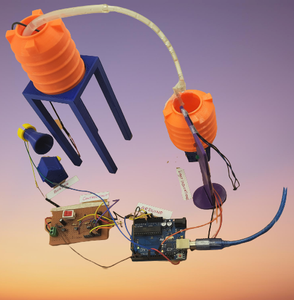

Introduction: Microcontroller Based Water Level Controller With Water Level Indicators and Auto-cutoff
People generally worry about the wastage of water when they switch ON the motor and forget to switch OFF the motor. This project may help them in saving water for the future.
A water level detector is used to control the water level in the tank.
In many industries like chemical, there is a restriction on the liquid level of the container in such cases level controller can maintain a level of the liquid at the desired level.
The device works on the principle that the water is capable of passing a current through it. One wire which is connected to VCC is left in the bottom-most part of the tank and the rest wires are set at different levels in the tank. Except for the bottom-most wire which provides VCC to the whole water, we have two wires set at different levels one is for medium level and another one is for full. Another terminal of these two wires is connected to the base of transistors and hence in turn to the microcontroller which is the heart of the device. When water starts rising, different levels touch the water and get some positive voltage. This positive voltage is given to the base of transistors to activate them and hence passing the signal to the controller. The indicating component is LED. This component shows the current status of the water in the tank. Green LED is used for indicating the medium level of the tank and Red LED is used for indicating the full level of the tank.

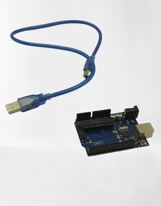

Step 3: Arduino
Arduino is an open-source electronics platform based on easy-to-use hardware and software.
It has different input /output pins of the microcontroller chip into digital input/output pins and analog input pins. Now, this board can be programmed using an awesome Arduino IDE (free to download). Arduino comes in different shapes and sizes.

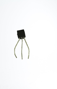

Step 4: Transistor
A transistor is a device that regulates current or voltage flow and acts as a switch or gate for electronic signals. Transistors consist of three layers of semiconductor material, each capable of carrying a current.
Here we are using a BC548 NPN transistor.
1.Collector (Current flows in through collector side)
2.Emitter (Controls the biasing of the transistor)
3.Base (Current Drains out through emitter side)
They are used as amplifiers and switches. As the amplifiers, they are used in high and low level, frequency stages, oscillators, modulators, detectors, and in any circuit need to perform a function.

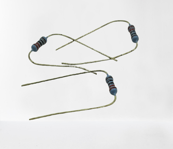

Step 5: Resistor
The resistor is a passive element in an electrical circuit. It doesn’t produce any energy on its own. It just dissipates electrical energy in the form of heat.
It is like a current limiter. It limits the amount of current flowing through a device(load).
Suppose you have to apply a certain current of 5 amperes to a device input and you have 10 amperes source so what would you do?
Answer: Add a resistor in series connection to limit the current.
This resistance will create a voltage drop (reduces the voltage in that area or drops potential) thus reducing the current passing through it.

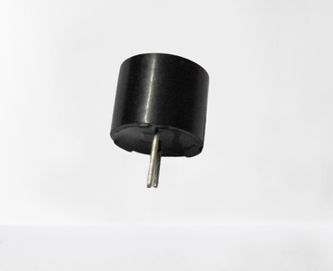

Step 6: Buzzer
A piezo buzzer is a sound-producing device. whenever an electric potential is applied across a piezoelectric material, a pressure variation is generated.
A piezo buzzer consists of piezo crystals in between two conductors. When a potential difference is applied across these crystals, they push one conductor and pull the other conductor by their internal property. The continuous pull and push action generate a sharp sound wave.
Piezo buzzers generate a loud & sharp sound. So, they are typically used as an alarm circuit. Also, they are used to make an alert of an event, signal, or sensor input.
Typically, piezo buzzer produce can generate a sound in the range of 2 to 4 kHz

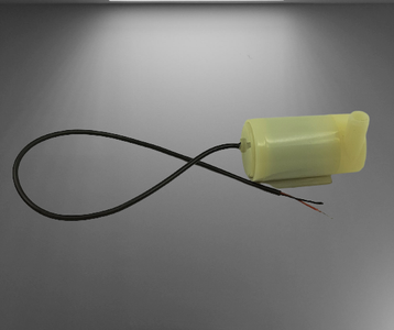

Step 7: Water Pump
A submersible pump is a pump that can be put in the water. The electric motor is sealed in such a way that the power line and the spinning shaft are sealed to prevent water from coming in.
The pump will pick up the water around it and pump it out an outlet port.
submersible pumps are needed to control water movement in the tank and ensure the proper flow of water.

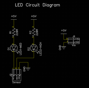

LED connections:
Green LED:
1. Positive terminal of LED with resistor one end ---- resistor second 5v of Arduino pin
2. Negative terminal of LED ---- Arduino 8th pin
Red LED:
2. Negative terminal of LED ---- Arduino 12 pin

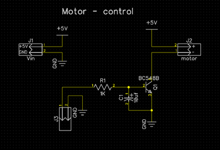

Motor connections:
1. Positive terminal of motor -- 5v of Arduino
2. Negative terminal of motor -- collector terminal of transistor(BC 548)
3. Base terminal of transistor -- Arduino 5th pin
4. Emitter terminal of transistor -- Gnd of Arduino

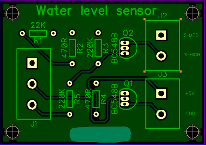

Water level sensor:
Middle-Level detector:
1. Collector terminal of Transistor -- Arduino 2nd pin
2. Base terminal of Transistor -- fix with the middle level of the tank
3. Emitter terminal of transistor -- Gnd of Arduino
Full Level detector:
1. Collector terminal of Transistor -- Arduino 4nd pin
2. Base terminal of Transistor -- fix with the top level of the tank
One end of resistor -- 5V of Arduino
The second end of resistor -- fix with a base of the tank
Step 9: Schematic Diagram(Diptrace) - Water Level Sensor
Here we are using Transistor BC 548 (NPN). It acts as a Switch. Initially, there is no voltage applied to the base of the transistor Q1 and the transistor is in an OFF state and no current is flowing through the collector, and the emitter and LED are in the OFF state.
When the water level reaches point A(Medium) in the tank, the positive side of the battery is connected to the base of the transistor Q1 through the water. So when a positive voltage has been applied to the base of the transistor Q1, it gets into an ON state, and the current starts flowing from collector to emitter and GREEN led glows. R3, R5 at the base of each transistor, which is used to limit the maximum base current. When the water level reaches point B(HIGH) in the tank, the positive side of the battery is connected to the base of the transistor Q2 through the water. So when a positive voltage has been applied to the base of the transistor Q2, it gets into an ON state, and the current starts flowing from collector to emitter and RED led glows and the water pump or motor can be turned off.
Step 10: Schematic Diagram(Diptrace) - Motor Control Circuit
The circuit consists of a transistor Q1 (BC548) NPN transistor, driven by the PWM from Arduino. The resistor is to limit the current to the base, but enough to operate the transistor in saturation when the input is high. The circuit is supplied by a 5V power supply. It starts the motor from slow to the fastest, then slower again until it stops, and repeats the cycle.
Step 11: Schematic Diagram(Diptrace) - LED Indications
One end of the resistor is connected to the 5V power supply and another end of the resistor is connected to the positive terminal of the LED and the negative terminal of the LED is connected to the digital pin of the Arduino pin.
Step 12: PCB Layout - Water Level Sensor Circuit

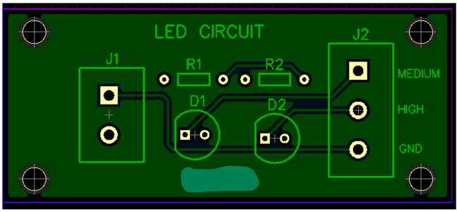

Step 16: PCB Layout - LED Indications

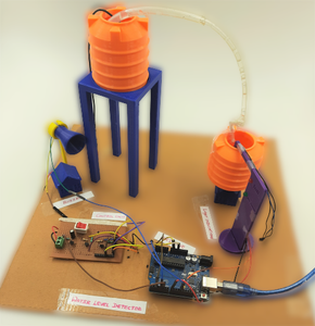

Step 18: Physical Building : PCB Connection
Step 19: Prototype - Testing Process
Step 20: Physical Building -wiring Setup

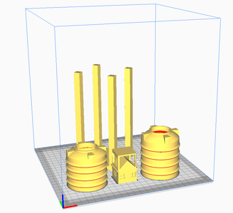

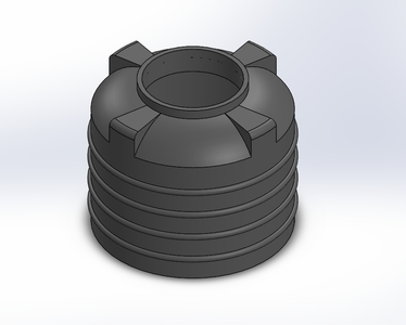

Step 21: 3D Image - Water Tank
Step 22: 3D Printing - Ultimaker Cura
Export each component as an STL file, and send them to the Ultimaker Cura 3D printing software.I used the following settings in the Creality Ender 3D printer.
Printer Nozzle Size: 1mm
Supports: enabled
Retraction Distance: 10 mm
Retraction retract speed: 60 mm/sec
Prime speed: 30 mm/sec
Z hop when retracted: enabled
Max Z speed: 120 mm/s
Z hop height: 1 mm
Travel speed: 200 mm/s
Layer height: 0.15 mm
Print temp initial layer: 200 Temperatures
Print Bed Temperature: 60 Temperatures
MainPrinting Temperature: 180 Temperature (degrees) for main print
tempOverhang: 30 degrees
Brim: enabled
Support Pattern: GridSupport
Placement: Touching build Plate
Support Overhanging
angle: 45
All the other settings: default
Material: PLA
Infill Density: 10Initial
Layer height: 0.2
