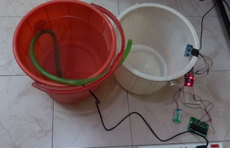

yeah there is a way just using a Ultrasonic sensor, this is very simple where the level of water is measured using ultrasonic sensor which gives the depth , by determining the tank depth we can set the maximum and minimum level
Step 1: Circuit Diagram
This water level controller uses only two components apart from arduino
1. HC-SR04 Ultrasonic sensor
2. relay board
Step 2: Working Model
Note : give the distance according to your specification, I've used a small bucket where 25 is the minimum level to turn ON the motor and if the water level reaches a distance of 10cm or lesser than that the motor automatically stops.
Step 3: Arduino Program
