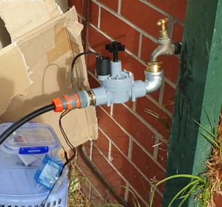

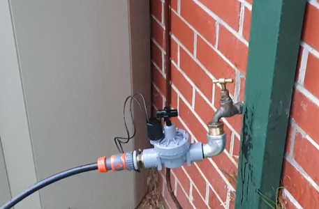

Step 1: Attach the Threaded Reducing Adaptor
find the tap you want to use
Step 2: Connect Your Fit Elbow
fit elbow
Step 3: Connect the Solenoid Valve
Step 4: Connect the Thread Hex
Step 5: Add a Hose Connector to the End
Step 6: Screw Off the End and Connect a Hose

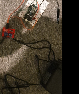

Step 7: Begin Seting Up Your Particle Device
Step 8: Connect Your Moisture Sensor
Step 9: Connect Your Particle Device to the Driver Module
Step 10: Plug in Your Device and Flash the Code Provided

Step 11: Go to Particle.io/integrations and Create a Webhook
Step 12: Go to Thingspeak.com and Create a Channel With Field 2 Enabled
Step 13: Go to Ifttt and Create an Particle Event to Google Docs
Step 14: Connect Your Raspi to Integromat and Google Sheets

Step 15: Finally Connect You Valve and Power Source to the Module
