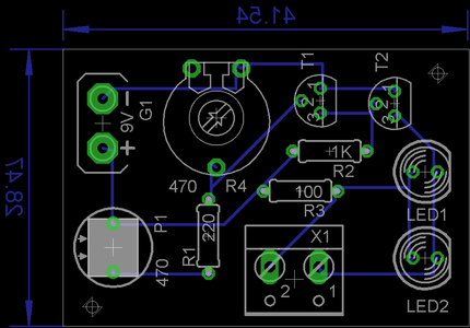

Step 2: ​Schematics and Circuit Explanation
The above picture shows the schematic used in this project. Working principle is quite simple: P1 is the photoresistor. It is a variable resistor that changes its value according to the amount of light hitting it. The more light shines on it, the higher its resistance value will be. This means that during the day its resistance will be highest and no current will be allowed to pass through it, whilst at night it will be lowest. When night comes, it gets darker and darker and P1's resistance will get lower and lower, until enough current will be let through, to overtake resistance provided by R1+R4, and trigger T1's base. Current taken by T1's base will be amplified, taken by T2's base, amplified again and sent to the LEDs: "and there was light"!!! R4 is a trimpot that allowes you to set a threshold: the higher its value, the darker it needs to be to trigger the LEDs, and that's why the value you'll be using could be higher or lower than 470 Ohms, so choose it according to the darkness of the place you want to light. I think that a good compromise could be 2KOhms or even 5Kohms, but you'll have to experiment!
Step 3: ​Let's Build It, Shall We?
Here comes the fun part: time to heat up your soldering iron! This build is quite simple, so the image above should be clear enough. it should be easy to assemble this circuit both on a perfboard and on a PCB. I suggest you start by soldering the lowest components, like the resistors.
In order to reduce power consuming, I chose to use a normally closed button to interrupt the circuit: I mounted it on a bracket, so that when the door is closed it presses the button and circuit is open (switched off). You can use a microswitch if you have one. I also decided to divide LEDs in two pairs because I had to illuminate two spots: two LEDs are mounted directly on the board, two others are connected through screw terminal X1 to reach the second spot.
