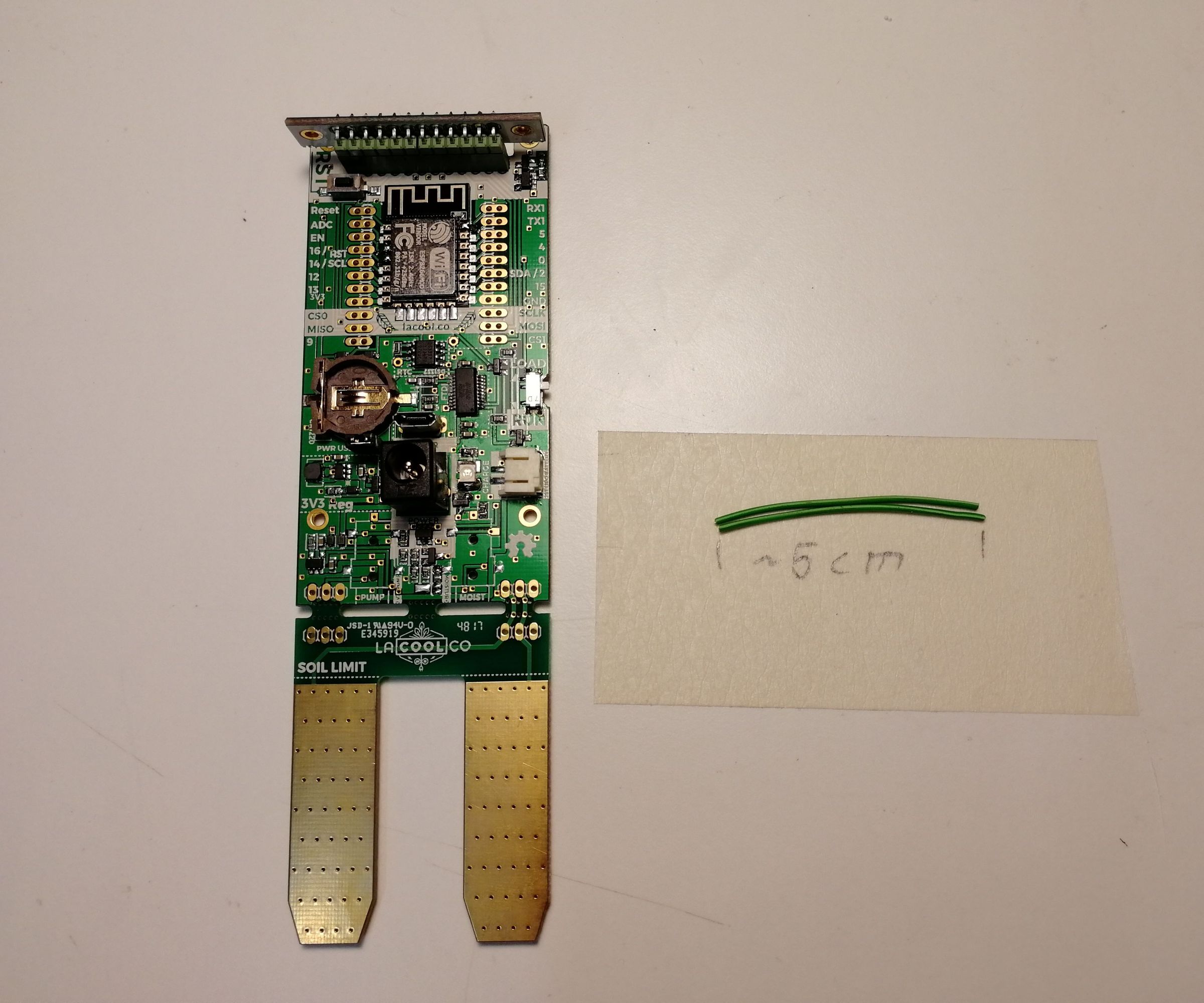

Now go to your new Arduino project on your computer. In the directory you see the .ino File and a data directory (photo 2), take a look at the data folder. As you can see there are 10 files named COOLsomething.json (photo 3). Open coolBoardActorConfig.json!
You can change the values if you want to, or you can just use them as they are. Well now I could say that everything is detailed in the Readme.md in the library, but since it's actually really easy I will explain it quickly :
"actif":1,
"inverted":0,
"temporal":0,
"low":[50,0,0,0],
"high":[40,0,0,0],
"type":["soilMoisture",""]
} actif : defines if we actually use the onboard actor, set it to 0 (zero) to deactivate.
inverted : Let me use a simple example. If you switch on a heater the temperature rises, but if you use a cooling element (like a fan or the cold side of a peltier) the temperature gets lower. So the actor with the cooling element reacts in a inverted manner on the metric we monitor. Got it? please comment if this is clear..
temporal : A actor that works with time, we speek later about that.
low : if the metric goes above that value the actor gets low. Watch out if you use the inverted flag!
high : if the metric goes below that value the actor gets high. Watch out if you use the inverted flag!
type : what metric is used to control our actor? in this case it's soilMoisture, but we don't know where he is coming from :(
Now take a look at coolBoardSensorConfig.json (photo 5). This is the configuration file for all sensors onboard. On the bottom you can find soilMoisture ;)
You can change the values if you want to, or you can use as them as they are.
All you have to do is upload the sketch and the SPIFFS and your COOL Board is ready.

Step 2: Solder the Driver Board
First cut the USB cables so that we have one Cable with a USB-A Connector for the power supply and a second cable with a micro-USB to power La COOL Board (Photo1). Then Strip of about 5cm of isolation from each cable. You should have at least 4 Wires (5 in my case : red, black, green, white and ground). Usually 5 Volt is red and ground is black, but please check with a Multimeter (photo 2). Cut-off the other wires, we only need power (red and black wires)!
Take a Look at my fritzing (photo 7), if you already done some electronics with transistors or FETs I am sure this is easy for you. If you have no clue what we are doing with a FET I highly suggest you taking a look over here and here. Please give it a try as this is the very foundation of electronics and it's essential to know if you want to do electronics...
First we solder the transistor. Here are some tricks for soldering some fancy Surface mount Driver on perfboard :
- Take the 3 male pinheader and solder them on the prototype board (photo 3)
- Put some solder on one pin (photo 4) do the same with the FET's pins
- Solder just one Side and check for alignment (photo 5)
- If it's ok solder the other two pins
- Voila!
Now solder the resistor, Diode and Led. You can put some wires on the Led like I did or just solder it on the board like in the fritzing. At the end solder the USB cables and the wires for the pump.
Check for shorts, plug the power supply and the COOL Board and check if it's starting. If not unplug everything and use the multimeter to find the error!
