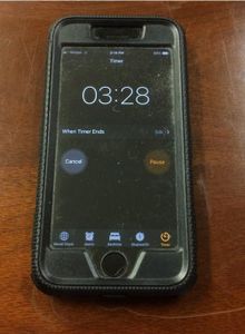

The timer is the most important part of your line bender! The time is critical when heating because ACRYLIC WILL CATCH FIRE if it gets too hot! And good timing is also important to successful cooling. In short, for the success of your project, and the safety of your workspace and anyone around you, the timer is critical.
For my early test runs I used the timer on my phone. It is precise, but using the phone meant that I was constantly looking and running when the alert sounded. And for the 2-4 minutes in between, I was bored and annoyed while I waited.
I needed a reliable timer that would not only pay attention to the timing, but also switch off the power (preventing fires and ruined projects) and give me a definitive audio alert when it was time to close the folding arm, and when it was safe to remove the cooled project
Note: If you decide not to automate your line bender, you'll want to add a switch to your power supply so you can turn the system on and off without having to unplug it from the wall.
