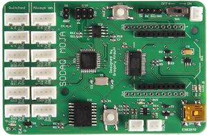

Step 7: Fitting the Autonomo
We use the Autonomo with an attached Grove shield. First install the communications module in to the Bee socket, attaching an antenna if required. Then connect the TPH board to the I2C socket on the Grove shield.
Step 8: Fitting the Rain-O-Matic
We use an industrial grade rain gauge made by Pronamic: The Rain-O-Matic Small (with the pole bracket accessory). The wires from the rain gauge are connected to a Grove screw terminal. Connect the blue wire to the 1st (signal) position and the brown wire to the 4th (ground) position of the screw terminal.
Step 9: Connecting Everything Up
Connect the Grove cable from the screw terminal to the Grove shield D4 socket. Connect the solar panel and battery and then close the box.
