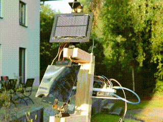

Step 1: Principle
Everyone has used a mirror to catch the sunlight and blind someone or give signals. To light up your house, you can stand in the landscape with a mirror in your hand, but that quickly becomes boring.
I want to automate that.
To do that, I first have to find out:
- Where is the target?
- Where is the sun?
- At what angle do I have to put the mirror?
With the upper Pan & Tilt unit we aim at a desired point using a small joystick and confirm the servo angles by pressing the joystick button. These x/y coordinates are stored in the EEPROM of Arduino.
After that, the tracker searches for the brightest light source, the sun, and also stores the set angles. At the same time, the tracker has aligned the solar cell with the sun to collect energy for future movements.
Then the mirror has to align itself by bisecting the angle between the sun and the target. This applies to both the x-axis and y-axis angles.

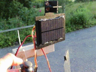

Step 2: Pan & Tilt Units
The Pan & Tilt units are available ready to buy. They don't hold much weight, but for our purposes it might be enough. Assemble them according to the instructions.
Well, it turned out that the microservos "SG90" together with the leverage are not very powerful. So I got myself some strong"MG996R" and built a pan & tilt device with two simple metal brackets (as shown in the picture).
Lower servo: x-axis
Upper servo: y-axis
The servos need a lot of current when in operation. Even at rest they draw energy.
Two tricks:
a) Install a capacitor between 5V and GND to reduce any tremors in the servos.
b) The assignment Servo1.attach(2) (i.e. the control of the servo by Pin 2) is only made shortly before the work command. After the work is done, the servo is detached again (Servo1.detach()). Then, for example, the servos for the mirror can be attached.
Step 3: LDR Sensor
In short, the optically separated light-sensitive resistors are used to determine in which direction the brightest light source is located (top left/right, bottom left/right) and the servos are then aligned until all four values are approximately equal. Then the optimal alignment is achieved.
I cut the LDR sensor partition from plastic and glued it. Solid cardboard is also suitable. An LDR is placed in each of the four compartments and fixed with hot glue. To be able to handle the cables better, I put the resistors that you can see in the circuit diagram on a small board and added connection pins.

Step 6: Mounting
I mounted the two units as close to each other as possible on a wooden frame. The slight angular shift with respect to the sun and the target is negligible. Make sure that the servos with mirror/solar cell can move without contact.
Step 7: Reflections
Of course you can also use only one pan&tilt unit. However, the servos with tracker and mirror would have to move back and forth during the search and would possibly cause disturbing light effects.
Step 8: Usage
