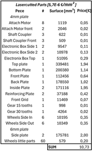

-6 wheels ()
-1.15 m^2 of laser cuttable wood (MDF 4mm)
-0.18 m^2 of laser cuttable wood (MDF 6 mm)

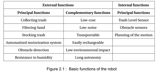

Basic Functions of the Device
The different required function for the robot are listed in the Figure 2.1
Requirement List
The functional analysis resulted in the requirement list illustrated by the Figure 2.2. The first requirements for dimensions are there to assess transportability of the device, along with the weight requirement and are related to requirement 26. Requirements on kinematics ensure the maneuverability on sand and a minimum speed. Constraints on materials have been added (23-25) ensuring that the material resists the conditions of the beach (high humidity, salinity, abrasivity of the sand, ...) and also affect how the robot is conceived and divided (insulation of electrical components, ...). Given the ecological aspect of the project, requirements on the impact of the robot on the wildlife and its ecological impact have been added. The impact of the use of the robot should be minimal, the material should be recyclable, or the pieces reusable. Although other energy sources could be used, electricity has been considered the only possible option for similar reasons, and its easier use on this scale of project, leading to requirements 11, 22. Constraints on the picking mechanism have also been developed to better quantify the needs, in the form of the minimal and maximal size of the collected trash, the filtering rate of the robot, the storage capacity, and the time needed to empty the robot. Requirements on the detection of obstacles have also been added (12, 13, 14), and on top of that, the robot should avoid going into the sea. Additional requirements such as quietness and low cost have been included in the chart.
Priorities are also included going from F0 to F2, with F0 being an imperative need, F1 a not negotiable but still flexible need, F2 a negotiable need with moderate negotiability.

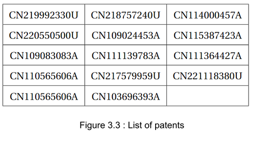

Patent Analysis
Seeking to deploy this product only in Belgium in a first time, and on a larger time-scale in the European Unions, patent analysis has been conducted on the Espacenet data base with combinations of words such as "Beach Cleaning Robot", "Autonomous" and so on. This resulted in a number of patent, and after verifying their status and their relevance, the Table of patents from the Figure 3.3 was created.
The analysis of three of these patents is shown in the attached Figure 3.4.
After analyzing the patents it was concluded that there is no freedom to operate. In fact, there are many designs patented, with very specific claims and for specific mechanism. However the global concept of such a robot is not patented. These patents also allow to see what means have been developed to tackle the various functionalities needed. Most of these designs use wheel or tracks a mean of locomotion while the waste collection systems are mainly conveyor belts and digging shovels. Energy is often supplied through solar panels and batteries. These patents can be used as inspiration as long as the resulting product does not fall under their claims.

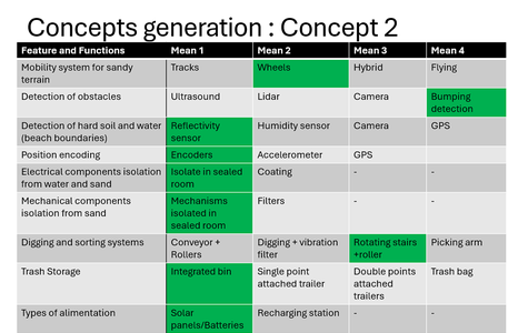

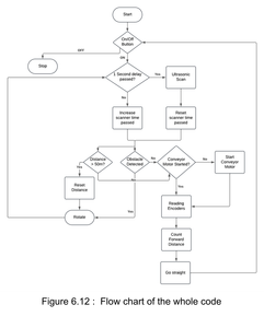

For the various functions of our robot, we have identified the challenges we need to address. We have carefully considered different methods for enabling the robot to move efficiently across sandy terrain, as well as for detecting obstacles, water, and tracking its position. Additionally, we focused on ensuring the protection of both electronic and mechanical components to prevent damage from environmental factors such as sand and moisture. We also explored the most effective waste collection and storage systems, as well as energy solutions to power the robot, ensuring it remains functional and sustainable throughout its operation.
To implement the different functions, implementation ideas have been developed.
Obstacle Detection and Position:
  1. Moving Plate System: A bumping system that activates a button when it comes into contact with an obstacle, triggering the robot to turn at that moment (cost-effective, reliable).
  2. Reflectivity Captor: Detects water by measuring the amount of light reflected off the surface, with water reflecting less light than dry surfaces.
  3. Ultrasonic Sensor: Detects obstacles by emitting sound waves and measuring the time it takes for them to reflect back (expensive, easy to manage).
  4. Camera in Front of the Robot: Detects obstacles and water by capturing visual data and using image processing to identify objects and distinguish between water and other surfaces (most expensive but more versatile).
  5. Humidity Sensor: Identifies areas with increased humidity, which are likely near water sources. This information helps the robot avoid water to prevent potential damage to its components (smooth and reliable operation in beach environments).
  6. Lidar: Scans the environment, creating a 3D map of obstacles in its path. This allows the robot to navigate effectively by identifying and avoiding obstacles with high precision (can be used in complex and dynamic beach environments).
  7. GPS: GPS coordinates guide our navigation and ensure the robot avoids areas close to water. This dual functionality allows the robot to maintain safe and accurate movement across the beach while staying away from moisture-prone zones that could damage its components.
  8. Encoder: Provides precise data on distance traveled and speed, enabling accurate navigation and control. This ensures the robot can move effectively across sandy terrain while maintaining a clear understanding of its position relative to its surroundings.
  9. Accelerometer: Helps determine changes in movement and orientation, providing additional data to ensure stability and accurate navigation. This is particularly useful on uneven sandy terrain, where maintaining balance and proper positioning is critical.
Collecting Waste System:
  1. Rollers and Moving Stairs: Consist of a fixed part and a mobile part that lifts the debris, while the rollers help push the debris towards the collection area (not patented, avoids accumulation of sand, but too complex with too many pieces).
  2. Picking Arm: Grabs the debris by using a mechanical gripper or claw to lift and collect the waste (not continuous, slower).
  3. Digging and Vibration Filter: Uses a digging mechanism to loosen the debris from the ground, while vibration helps separate finer particles from the waste, making it easier to collect (more vibration means higher risk of damage; the waste might not go up unless additional support is added).
  4. Roller Plus Conveyor Belt with Holes to Filter: Helps collect debris by using the rollers to push the waste onto the conveyor belt, which then transports it to the trash (easier to assemble, but needs testing).
Here’s the revised version for managing sandy terrain:
Managing Sandy Terrain:
  1. Wheel: A 3D printed wheel with a wooden support, using a wooden frame to provide stability and structure. This design allows the wheel to move effectively across various surfaces, with the precision of 3D printing and laser-cut wood to ensure accuracy.
  2. Flying: Uses a propulsion system, such as drones or rotors, to lift the robot off the ground, allowing it to move across the terrain without physical contact (expensive, requires assistance to move, not fully autonomous).
  3. Tank Track: Utilizes continuous rubber tracks instead of wheels, providing better traction and stability on sandy or uneven terrain while distributing the robot’s weight more evenly (increased friction, more complex mechanical device).
Trash Storage:
  1. Trash Bag: A lightweight, removable storage container for collected debris, allowing for easy disposal and replacement. It's easy to pack and light.
  2. Removable Tank: A detachable container used to store collected waste, providing more capacity than a trash bag and making it easier to empty and replace when full. Although more cumbersome, it offers a simpler design for the removal mechanism.
  3. Trailer: A detachable storage unit that provides additional capacity for collected waste. It attaches by one or two points on the robot, offering more space but potentially reducing stability due to its size and weight.
Protection of the Mechanism from Sand and Humidity:
  1. Encasing of Electrical Components and Mechanism: Enclosing sensitive parts in a durable, sealed casing to shield them from water, sand, and other environmental factors. This ensures longevity and reliable operation in harsh conditions.
  2. Coating: Applying a protective layer, such as a conformal coating or epoxy resin, over electronic components. This shields them from sand, moisture, and corrosion, allowing for optimal functionality and durability in beach environments.
  3. Filters: Placing filters over moving parts or openings to block fine particles while still allowing airflow or movement. This helps keep the mechanical systems operational, preventing damage caused by sand accumulation.
Turning System:
  1. Differential Rotation of the Front Wheels: Independently controlling the left and right wheels allows the robot to turn by varying their speeds. This provides more maneuverability, enabling sharper and more flexible turns.
  2. Ackermann Steering System: Uses a mechanism where the front wheels are turned at different angles, ensuring smooth and sharp turns. This system ensures that all wheels follow the same path, ideal for precise navigation.
Preliminary Concepts
We have thoroughly evaluated various design approaches for the robot's functionality and performance. To determine the best solution, we developed three distinct concepts, each incorporating different systems and configurations. By analyzing the performance, feasibility, and efficiency of each, we were able to select the most suitable design to meet the project’s goals.

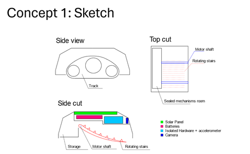

First Concept
This design features tracks for movement, ensuring the robot can navigate diverse terrains. A camera is integrated for obstacle and water detection, enabling smooth operation in dynamic environments. The robot’s position is tracked using an accelerometer, while sensitive electronics and mechanical components are securely housed in an isolated room to protect them from external elements. For waste collection, rotating stairs and a roller mechanism are employed, with an integrated bin for debris storage. Energy autonomy is achieved through solar panels and batteries, ensuring sustainability and functional efficiency for waste management.
Second Concept
In this design, the robot uses wheels for movement and a bumping system for obstacle detection. A reflectivity sensor detects water, ensuring the robot avoids moisture-prone areas. The position is tracked with encoders, while the mechanical and electronic components are housed in an isolated room for protection. A rotating stairs and rollers system is employed for waste collection, with an integrated trash bin for storage. The robot’s power needs are met through solar panels and a battery, providing efficient energy usage.

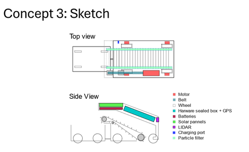

Third Concept
This concept uses wheels for movement, complemented by a LIDAR system for obstacle detection. The robot utilizes GPS to detect water, while encoders track its position. The electronics are housed in an isolated room, with mechanical components protected by filters to prevent sand damage. The waste collection system includes digging and vibration mechanisms for debris separation, and a single-point attached trailer for waste storage. Solar panels, a battery, and a charging station ensure effective energy management, promoting sustainability.

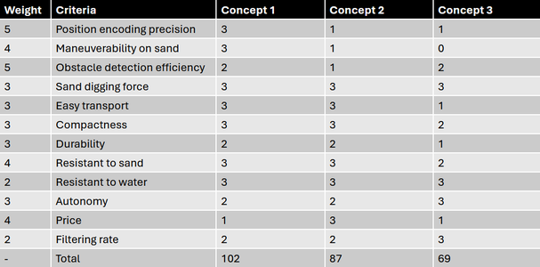

Selection
After comparing the three concepts, we created a weighted scoring table based on key criteria, such as efficiency, cost, environmental impact, feasibility, and patent considerations. The results are summarized in the table provided.
First Concept
The first concept emerged as the most efficient choice due to its balanced performance in terms of cost, functionality, and environmental impact. The tank tracks provide excellent traction across varied terrains, ensuring stable movement on the beach. The integrated camera system offers dual functionality for both obstacle and water detection, enhancing the robot’s versatility. The use of an accelerometer for position tracking is both cost-effective and accurate. The isolated compartments protect sensitive components, boosting durability. The waste collection system—comprised of rotating stairs and rollers—is both effective and unpatented, ensuring originality. Additionally, the integrated trash bin offers practical storage. The combination of solar panels and batteries ensures energy efficiency and minimal environmental impact by utilizing renewable energy sources. Overall, the first concept proves to be a cost-effective, environmentally friendly, and high-performing solution for the project.
Step 5: High-Level / Embodiment Design Design
For the embodiment design, a distinction must be done between the final product and the prototype. This first section will detail the final product while the second about the prototype.
Final Product
3D Model and diagram:
The 3D model of the robot is shown in the Figure 5.8
On the Figure it is possible to see the tracks of the robot attached to the casing, the digging mechanism inside and the camera in front. The track systems are powered with 24V DC motors.

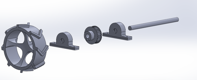

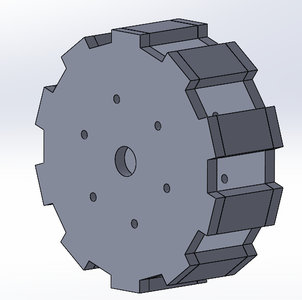

Prototype
The fprototype is compose of the following subsystems:
The main box : Wooden assembled casing to place all the electrical and mechanical components.

Manufacturing Processes And Materials For The Prototype
The manufacturing processes available in the FabLab are laser-cutting MDF and 3D printing. The most commonly used for this robot is laser-cutting due to its speed and the simplicity of the pieces to create.
MDF has many advantages, including its low density (680 kg/m³) and low cost. Although MDF is less recyclable than PLA from 3D printing, it is strong and stiff enough for the prototype of this beach cleaning robot.

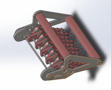

Trash Picking System
Following the original concept proposed, the following model of the picking system has been developed.
The subsystem is composed of two wooden reinforced structures, with pre-drilled holes for the addition of ball bearings for the rollers. Two rollers are placed at the bottom, supporting the conveyor belt, which spans the entire width of the system. Additionally, one roller is added at the front, on which flexible cloisoning is fixed. The four cloisoning pieces are made of vinyl, designed for floor covering, with various indentations to provide different levels of rigidity. This design helps both capture trash and propel it toward the storage box.
An additional shovel-like wooden component is placed in front of the mechanism. This component helps guide trash into the opening and the rollers while simultaneously filtering sand, thanks to the ridges on its sides.
The conveyor belt is made from a simple bath carpet, stapled at the ends to form a loop. Since the carpet features holes, sand is also evacuated during the lifting of the trash, ensuring effective separation and collection.

ii. Conceptual Design
As developed in the previous sections, the two main conceptual designs considered for this have been the Rollers and Conveyor Belt, or the Rotating Stairs.
The initial design planned for the prototype was the Rotating Stairs mechanism. This design needed a lot of different pieces with specific forms and was difficult to realize. In fact, to make these pieces, 3D printing could have been used, but this would have taken a non-negligible amount of time, cost money in printing filament, and would have had too big an impact on the environment, therefore being counterproductive.
The mechanism would have dug into the sand, lifting the trash one step at a time, slowly bringing it up, while filtering the sand by letting it fall in between the claw-like rotating stairs. The trash would also have been assisted by rollers in the front and in the back of the mechanism, and in the end, would have dropped into the trash storage part.
This design had the advantage of not being patented and being original, and could have been adapted to laser-cut MDF wood to produce a proof of concept. It would, however, also have required a lot of materials such as ball bearings, and so on, and would possibly not have been resistant enough to lift weights. Moreover, the assembling process would have been cumbersome, and any mistakes could have ruined the entire mechanism. However, this principle has been kept for the Design Methodology part of the project.
The second envisioned mechanism was the Roller plus Conveyor Belt mechanism. This design requires fewer different elements but also has major downsides. In fact, finding suitable material for the conveyor belt was extremely difficult. After tests were conducted with vinyl, the conclusion was made that this material was too rigid for our prototype and that another solution had to be found. A simple carpet bath was finally found, which was more flexible, had a good amount of texture to bring trash up, and had holes that could help the sand be filtered while the trash was conveyed.
The idea of this mechanism is that objects pushed inside by the rollers would be propelled onto the conveyor belt, and would end their course in the trash storage part. The ridges in the front shovel-like part help prevent sand from being pushed into the system, while the conveyor belt is also holed. In the trash storage part, a final filter is also present to let any sand that would be in the trash drop.

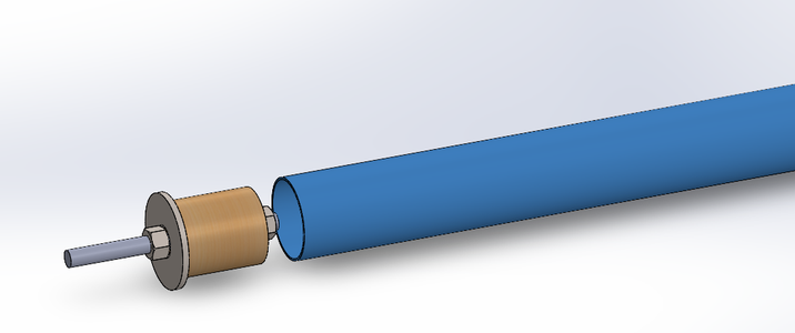

A) The Rollers
These rollers were made from PVC pipe, in which threaded M8 shafts have been fixed. Additional metal rings have been added to the extremities of the pipes to seal them up.
In the top rollers, 6 additional holes have been drilled with a size of M3. Six threaded M3 rods (4 cm long) have been placed in these holes, while 4 pieces of vinyl have been cut and pierced to attach them, as shown in the following picture.
Moreover, one of each roller (top and bottom) has longer threaded rods to add the pulleys.

E) Shaft Couplers
The first shaft coupler was made of one 20 mm long nut (metric 8) so the shaft is screwed, and two screws tighten the motor shaft. However, achieving and maintaining perfect alignment of the two shafts during rotation is difficult.
The second solution is the use of a laser-cut piece to make the transition from the motor to the shaft via a nut.

A) The wheels
Six M3 holes were drilled into the wheels to extend them. The wooden extensions were fixed to the plastic wheels using the threaded M3 rods and bolts on each side. Additionally, 10 wooden rectangular pieces were added to each wheel and glued to each ridge.
B) The shaft bearings
By taking 2 wooden pieces with 8mm holes and 2 wooden pieces with 22mm holes, 2 nuts, and two M3 bolts, and assembling them with a ball bearing, simple shaft bearings were created.
iv. Final Assembly
For each assembly, the process is the same but symmetrically. In one plate, the two shafts powered by the motor are fixed, and the transmission of power is made by belts, which distribute it to both shafts. The third shaft is fixed on an independent plate, so the moving mechanism on one side just needs to be screwed onto the bottom of the robot. The motor is placed at the back of the robot, and the structure is assembled such that the shafts align with the holes made for this purpose in the side plates.

The code was developed in several parts: the picking mechanism, the motion mechanism, and the obstacle detection.
For the picking mechanism, the code was designed to enable or disable the output pin that controls the transistors. It was first connected to a simple LED instead of motors to ensure the functionality and avoid breaking any components if the circuit had issues.
For the motion mechanism, the encoder pulses were read for a certain duration. The pulses per rotation were divided by the time, and the speed of the motors was calculated. Then, by using a proportional regulator, the voltage of the motors was adjusted so they matched the desired speed. Another part of the code was designed to determine the correct speeds of the motors in order to move in a straight line or make a turn.
For the obstacle detection mechanism, a signal was sent to all three sensors, and their returned values were filtered. If the distance was too high, then the reading was considered incorrect, and the value was not taken into account. If the reading was within the desired range, it was kept. Finally, all the readings were compared, and if one of them was below the specified threshold, a turn was triggered

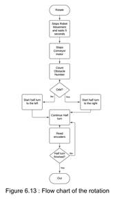

iii. Code flow diagram
The code flow diagram can be found in the figures 6.12 and 6.13
iv. Testing
The code was first tested by parts. First, the robot was elevated so the wheels did not touch the ground. This way, it was possible to test the integrity of the whole moving mechanism more easily. The code was updated to make the robot go forward and make 180-degree turns.
Then, the two motors were powered directly into the picking mechanism using the flyback circuit. Some objects were placed in front of the mechanism to verify if it could pick up the trash and store it.
Due to time limitations, the detection of obstacles was not entirely tested, although the sensor code for the distance was verified. The sensors were able to provide a relatively precise distance of the objects in front of them.
Therefore, the first full test of the robot was done by just alternating straight movement with 180-degree turns, while enabling and disabling the picking mechanism.

The firt part of the moving mechanim is the bearing attach. This piece is made form 4 wooden pieces attached together with bolts. Inside each attach is inserted a ball bearing with a salvaged rubber band, to prevent the bearing from moving or slipping inside its casing.
Then, the axles are assembled. The belt pulleys provided by the fablab are inserted into the the salvaged and cut metallic rods. Then on each rod is added other salvaged rubber bands. Finally two bearing attaches are inserted on the edges. The rubber bands are on each side of the attaches to prevent the rod from slipping, without constraining its rotation.
Once the 6 axles are finished, they are attached to the wooden plates. The attach is done with metallic sheets that were bent to follow the shape of the wooden attaches. This way, the attaches will not move once fixed.
Two axles are attache on the l shaped wooden plates and one single per square plate. The square plate is designed for the free wheels that are not powered by the motors.
Before fixing the axles, the belts are inserted and stretched.
Finally, the motors are fixex in the wide area of the L-shaped pieces, the fixation is made with bent aluminum sheets in which holes were drilled. The motor has another pulley inserted in the shaft and attache to the rest of the mechanism with a small belt.
Step 2 : Wheels assembly (Figure 7.2) :
The wheels assemby is based on existing smaller wheels, salvaged from old car toys. To add thegrousers, first 6 equidistant holes must be drilled into each wheel. Then the two wooden edges are inserte an fixed with threaded rods and botls an hex nuts. In total 36 rods were cut from longer pieces and used.
Then the grousers pieces were attached, two options were possible. First to attach them with other threaded rods, or to fix them with wood glue. Although the wood glue is a irreversible process, the wheels must in theory never be disassembled again. Moreover using again threaded rods would have been time consuming since 60 aditionnal rods were needed, and each rod had to be cut. In addition to screwing everything.
