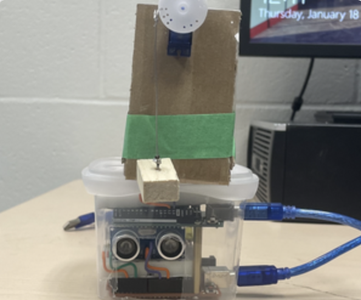

Introduction: Autonomous Crane
Welcome to this exciting DIY project where you'll create a gesture-controlled system using OpenCV, MediaPipe, Pyfirmata, and Arduino. In this Instructable, I'll guide you through the process of building a system that detects hand movements and controls servo motors, an ultrasonic distance sensor, photoresistors, and RGB LEDs.

Step 1: Attatch Servos
Get two servo motors, place in in three-legged pin beads and connect them to the breadboard. Connect the power of the servo directly to power (without resistor or any other component), and similarly attach the other servo motor to power. Further, you would need to provide the ground of the servo motors with the ground directly from the ground rail. Connect the signal for the first servo to PIN 12 and the pin of the second servo to PIN 13.
Step 2: Attach Distance Sensor
Now add an ultrasonic sensor. On a new breadboard The VCC is to be onnected directly to power, the ground should be directly connected to ground, the echo is connected to pin 13(new arduino), the trig is connected to pin 12 (new arduino).
Step 3: Attach RGB Led
Get one RGB LED, 2 light-dependent resistors and 2 LEDs. Connect the light dependent resistors to the ground and connect the ground of the leads to this light dependent resistor while the anode of the LED is connected to power. replicate this from the other set of light-dependent resistors and the LED. Then get a common anode RGB LED and connect the power to the power rail using a 330Ω resistor. red should be connected to pin 3 and green to pin 5

Step 7: Python Code
Run the attached Python script on your computer using a python compiler. This script uses OpenCV and MediaPipe to detect hand movements and controls the servo motors based on hand positions, and that would mark the end to the first breadboard.
Step 8: Arduino Code
Follow the second image in step#1 in order to prepare your second breadboard, which will detect the distance between your crane and your hand so that it is able to detect movements in your hand smoothly. After you have assembled the circuit, upload the attached code to another Arduino.
Step 9:
Once you run your code, you would have to wait for a minute for your code to compile, after which you can move your hand from one end of the screen to the other which will further cause the servos to move.
