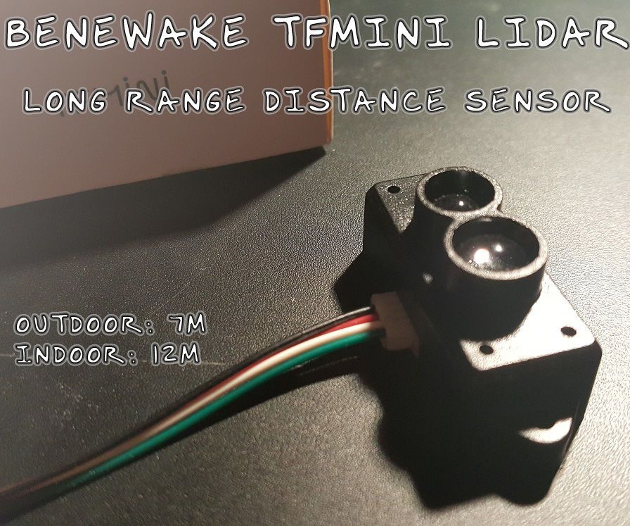

You can also connect a LiDAR to measure the distance and avoid obstacles. Instructions on how to connect it can be found here. Also here is a raw code for measuring distance, if distance is below a threshold then braking and landing.
