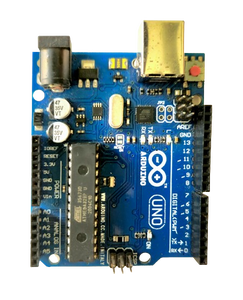

Arduino:
Arduino, a programmable microprocessor, enables the creation of an array of projects ranging from LED blinkers to robots and drones, while seamlessly interacting with a diverse range of devices and components.
This will serve as the brain of the rover. We can achieve our desired functionalities with Arduino by programming it according to our needs using the Arduino IDE
Specifically, I'll be using the Arduino UNO R3.

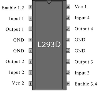

L293D IC
◆ INTRODUCTION
The L293D is a 16-pin Motor Driver IC (Integrated Circuit) specifically designed to control the speed and direction of motors. Motor drivers provide essential protection against back electromotive force (EMF) generated by the motors. Directly connecting motors to the Arduino board can risk damaging it due to this EMF.
◆ SPECIFICATIONS
Motor voltage Vcc2 - 4.5V to 36V
Supply Voltage to Vcc1 - 4.5V to 7V
Maximum Peak motor current - 1.2A
Maximum Continuous Motor Current - 600mA
Dimensions - 4 × 2 × 1 cm
◆ PINOUT
This IC requires external power to operate the motors but utilizes the Arduino's 5V supply for its own operation.
On one side of the IC, there are pins dedicated to controlling one motor, while the pins on the other side control another motor.
The IC has four GND pins and two enable pins, one on each side.
These enable pins are used to adjust the speed of the motor: connecting them to a PWM pin on the Arduino allows for variable speed control (PWM pins on the Arduino Uno are identified by the tilde (~) symbol next to the pin number). In the code, the speed can be adjusted from 0 to 255.
Alternatively, if you're not interested in varying the speed, connecting the enable pins to the Arduino's 5V pin will run the motors at maximum speed or very close to it.
If you examine the pinout image of the IC, you'll find that most of the pins are self-explanatory.
The following is the pinout:
L293D
pin 1 ↠ Enable 1
pin 2 ↠ Arduino digital pin
pin 3 ↠ Motor 1
pin 4 ↠ GND
pin 5 ↠ GND
pin 6 ↠ Motor 1
pin 7 ↠ Arduino digital pin
pin 8 ↠ External Power
pin 9 ↠ Enable 2
pin 10 ↠ Arduino digital pin
pin 11 ↠ Motor 2
pin 12 ↠ GND
pin 13 ↠ GND
pin 14 ↠ Motor 2
pin 15 ↠ Arduino digital pin
pin 16 ↠ Arduino 5v
Tip: You can identify the pins on an IC by using the small black dot at the corner as a reference point.

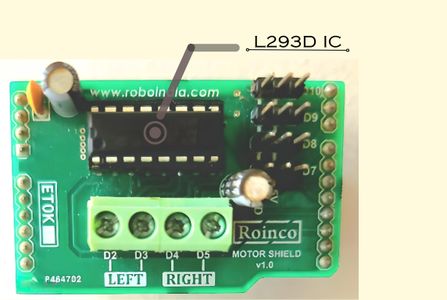

Motor Shield:
Most motor shields essentially integrate the L293D IC onto a PCB, providing a neater appearance and simplified wiring.
Here, I'm opting for a Motor Shield instead of the L293D IC due to the simplicity in making connections. The shield I will be using was included in an Arduino beginner kit I bought long ago.
Both the L293D and motor shield serve the same purpose in motor control, but the motor shield simplifies the setup process. Also, many motor shields on the market today offer more than just two motor control capabilities.

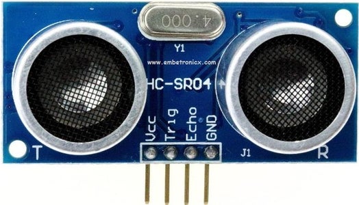

Ultrasonic sensor HC-SR04:
In this project, we're utilizing three of this sensor—one for each side except for the back.
◆ INTRODUCTION
The HC-SR04 is an affordable and easy to use distance measuring sensor which has a range from 2cm to 400cm
◆ SPECIFICATIONS
Operating Voltage - 5v DC
Operating Current - 15mA
Operating Frequency - 40KHz
Minimum Range - 2cm / 1 inch
Maximum Range - 400cm / 13 feet
Accuracy - 3mm
Measuring Angle - <15°
Dimension - 45 x 20 x 15mm
◆ PINOUT
• VCC: Connected to Arduino 5V.
• GND: Connected to Arduino GND.
• Trig (Trigger): This pin initiates the ultrasonic burst. When it receives a pulse or trigger signal, the sensor sends out an ultrasonic wave. It is an input pin.
• Echo: The Echo pin receives the reflected ultrasonic signal. When the transmitted signal bounces off an object and returns to the sensor, the Echo pin generates a pulse whose duration corresponds to the time taken for the signal to return. This is an output pin.
◆ HOW IT WORKS
It emits an ultrasound at a frequency of 40,000 Hz, which propagates through the air. If there's an obstruction in its path, the signal reflects back to the module. By accounting for the travel time and the speed of sound, one can accurately determine the distance.
◆ CALCULATING DISTANCE
By measuring the time it takes for the wave to return and considering the speed of sound, the distance to the object can be accurately calculated.
Using the average speed of sound in air (343 m/s), the distance to the object is calculated using the formula:
Distance = Speed x Time
The time being measured here is the time taken for the ultrasonic waves to travel to the object and return. Therefore, to obtain the time taken to reach the object, we divide the measured value by 2.
Distance = Speed x Time / 2
We need to convert the speed of sound, 343 m/s, to cm/µs (centimeter/microsecond) since all our other values are in that unit. We do that by multiplying the value with 100/1000000. This gives us 0.0343 cm/µs. Rounding off the value, we get 0.034 cm/µs.
Distance = 0.034 x Time / 2

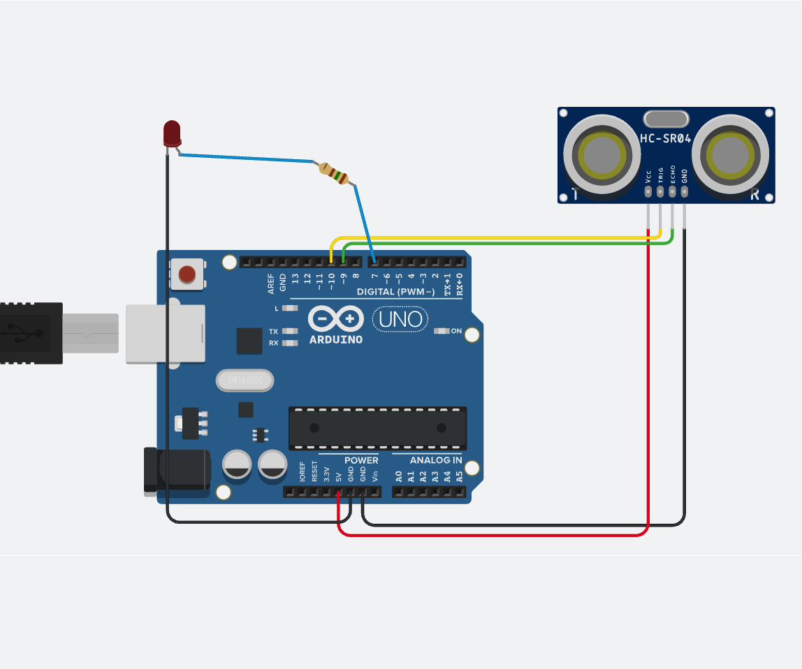

Step 1: Designing the Circuit
Before we get our hands dirty with assembling the hardware, let's kick things off by sketching out the circuit layout for our hand-following car project. This step is super important to make sure all the pieces come together smoothly and work nicely with our Arduino Uno.
I'm using Tinkercad to design and create the circuits for this project.
Tinkercad (www.tinkercad.com) offers a drag-and-drop interface and a wide range of components, making circuit creation a breeze. Its built-in simulation feature enables real-time testing and troubleshooting. Whether you're a hobbyist or a seasoned engineer prototyping a new project, Tinkercad's user-friendly interface simplifies circuit design. If you're new to electronics and curious to learn, I highly recommend giving Tinkercad a try!
As mentioned earlier, I'll be using a motor shield.

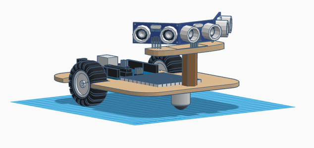

Step 2: Constructing the Car Chassis

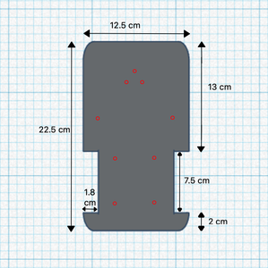

I've cut the chassis from cardboard. The dimensions are in the picture if you need them.
You'll also need to create holes on the platform for securing the components. The locations for the holes are also marked in red (The markings are not precise, you might not even need this much holes if you are sticking the components to the chassis).
I recommend planning ahead for the placement of the three ultrasonic sensors. This foresight can save you from potential struggles during the assembly process that I encountered.
To mount the motors securely, I highly recommend screwing or fastening them tightly to the chassis. I opted for screwing. To do this, I attached a lightweight multiwood block under the chassis using wood glue to provide a stable base for the screws.
If you're purchasing your chassis, ensure it meets your specific requirements. Look for one designed to accommodate two motors at the back, a caster wheel at the front, an Arduino, a breadboard, and three ultrasonic sensors. I doubt you'll find a chassis that perfectly fits these criteria, so you may need to make modifications or additions to customize it for this project.
Here's a 3D model...
Hand-Following-Robot-MODEL

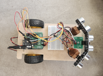

Step 3: Assembling Components Onto the Chassis
Motors
Let's begin by securing the motors onto the chassis. This ensures a sturdy foundation for the rest of the components.
Drill holes in the previously attached block for the screws and securely attach the L-shaped BO motors, ensuring that both motors are kept parallel to each other. Tighten the screws firmly to affix the motors securely to the chassis.
Castor Wheel
Position the wheel correctly over the pre-drilled holes and secure it with screws. Alternatively, you can use adhesive if preferred. Additionally, adjust the distance between the castor wheel and the chassis if necessary, especially if the front appears significantly lower than the back. I utilized double-sided screw extenders similar to these ones (link), to achieve the correct height.

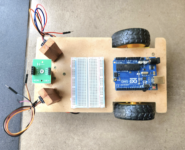

Arduino and Breadboard
You can simply use double-sided tape to fix the Arduino Uno and breadboard securely onto the chassis.
However, I chose to use screws since my Arduino already has pre-built screw holes.

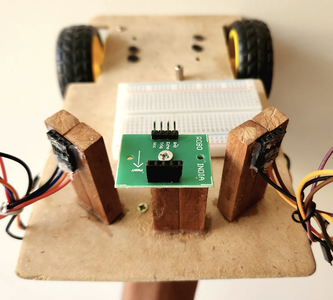

Ultrasonic Sensors
This is the most crucial part of the assembly process. There are many ways to secure these sensors, but I decided to mount them at a specific height. If you're doing this another way, just remember not to cover the two eyes of the sensor.
Placing them directly on the chassis shouldn't pose any new issues. If you are choosing this approach, pin them directly on to a breadboard for easier wiring.
Sensor Orientation:
  • Sensor-1: Positioned to face straight forward.
  • Sensor-2: Placed right next to Sensor-1 at a 45° angle.
  • Sensor-3: Positioned opposite to Sensor-2, right next to Sensor-1, also at a 45° angle.
Regardless of how you secure the sensors, achieving precise orientation can be hard. However, it's not necessary to achieve exact angles for the car to function properly. Try to get the angles as close to 45° as possible. In my initial attempt, I measured angles of approximately 40° and 35°, which still allowed the car to operate effectively.
External Power(Batteries)
An external power source might be necessary for your motor shield, depending on its type. While some motor shields draw power from the Arduino itself, this can result in a decrease in motor speed due to the Arduino's limited 5V output power. However, if you're using the L293D IC directly, external power will be required and should be inputted to pin 8 for the motor to run.
You can just use double-sided tape to attach it to the chassis.
The Arduino Uno also requires power to operate when not connected via USB. Therefore, you will need another battery pack to provide power to the Arduino.
Step 4: Wiring
Now comes the hard part, wiring.
Wiring the Sensors
The connections for the 4-pin ultrasonic sensors and Arduino are as follows:
Ultrasonic 1  ↔   Arduino
VCC ↔ 5V
Trig ↔ pin 9
Echo ↔ pin 8
GND ↔ GND
Ultrasonic 2  ↔   Arduino
VCC ↔ 5V
Trig ↔ pin 11
Echo ↔ pin 10
GND ↔ GND
Ultrasonic 3  ↔   Arduino
VCC ↔ 5V
Trig ↔ pin 13
Echo ↔ pin 12
GND ↔ GND
The 'Trig' and 'Echo' pins of the ultrasonic sensors can be connected to any available digital pins on the Arduino. However, if you're using a motor shield, most of the digital pins may already be occupied by the shield's connections. In such cases, many motor shields have additional headers for extending the pin connections, allowing you to access more pins. Please refer to your motor shield's datasheet for specific information on pin allocation.
Since we're using 3 ultrasonic sensors, we'll need a total of 6 digital pins for the sensors themselves. Remember, analog pins on the Arduino can also function as digital pins, if needed, without extra steps. The code remains the same. Just ensure correct connections and assign pins in the code.

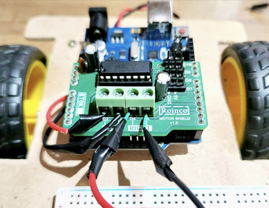

Wiring the Motors
If you're using a motor shield, consult its manual for connections. Most likely, you'll have an Arduino-mounted shield, and the only connections you'll need to make will be for the motor and shield.
The connections for the L293D IC Arduino are as follows:
L293D   ↔   Arduino
Pin 1 ↔ 5V
Pin 2 ↔ pin 5
Pin 3 ↔ Motor 1 anyone Terminal
Pin 4 ↔ GND
Pin 5
Pin 6 ↔ Motor 1 other Terminal
Pin 7 ↔ pin 4
Pin 8 ↔ External Power Positive Terminal
Pin 9 ↔ 5V
Pin 10 ↔ pin 2
Pin 11 ↔ Motor 2 anyone Terminal
Pin 12 ↔ External Power Negative Terminal
Pin 13
Pin 14 ↔ Motor 2 other Terminal
Pin 15 ↔ pin 3
Pin 16 ↔ 5V
The reason we left out some pins is because they are GND pins, and we have already connected the Arduino GND to pin 4 of the L293D. Pin 5, pin 12, pin 13, pin 4 all are GND pins.

1. Define Motor Pins
In this section also, we are assigning variables to the pins where we connected our L293D's pins 2, 7, 10, and 15. It just makes the code easier to read.
2. Define ultrasonic sensor pins
In this section also we are assigning variables. But to the pins where we connected our three ultrasonic sensors' Trig and Echo pins.

5. Function to move both motors forward
Here, we are defining another function named
Forward();
to move both motors forward. This is also achieved by using the
digitalWrite();
command to set pin 1 of both motors to HIGH.

9. Set ultrasonic sensor pins
Here, we set the Trig pins of each sensor as output and the Echo pins as input. This is because we send the signal to emit the ultrasonic burst through the Trig pin.
We obtain the time value from the Echo pin, which receives the reflected waves. Therefore, we set Echo as input because we need to read information from it.

Step 6: Working
Here are the videos of the car running and distance value printing on the serial monitor.
