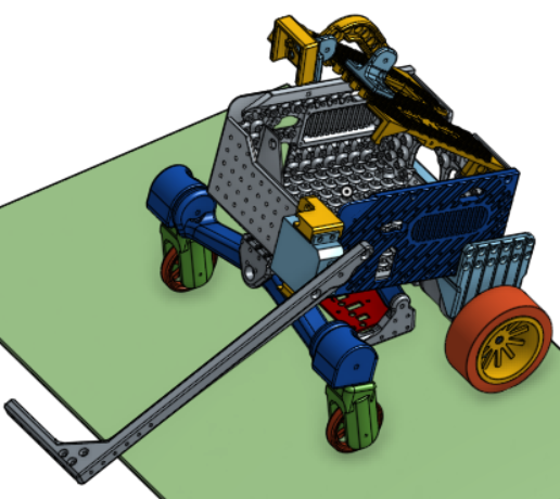

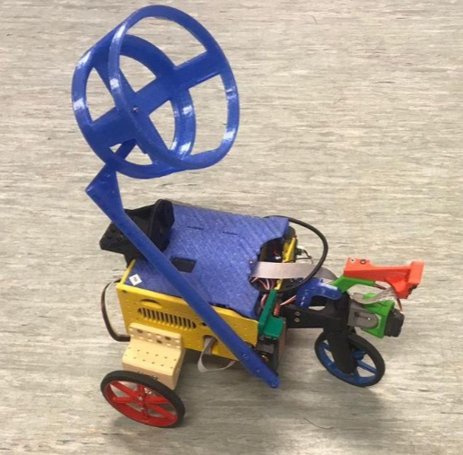

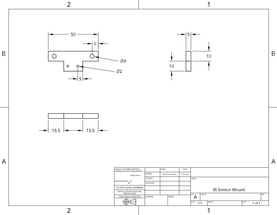

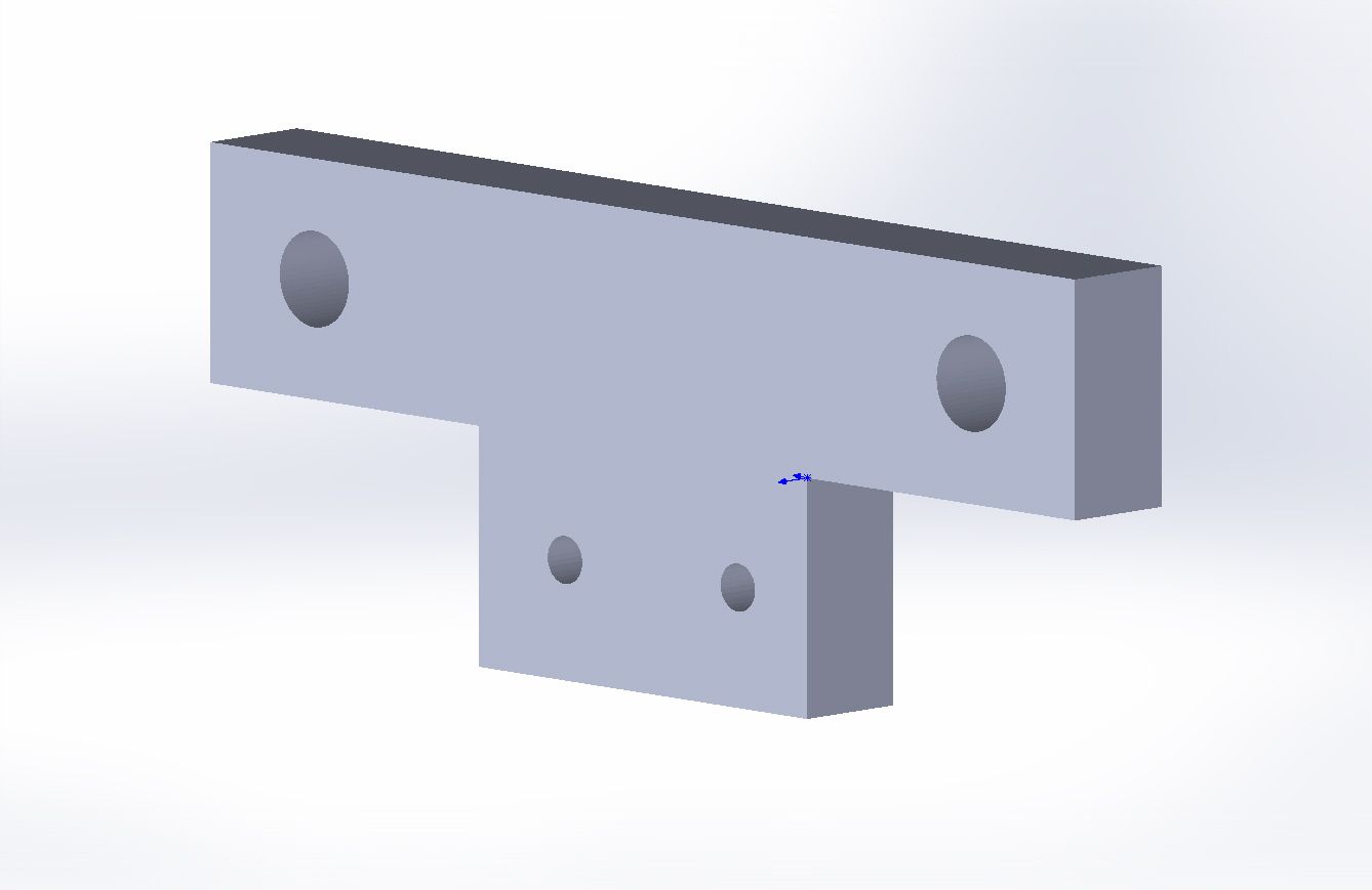

Step 1: Mechanical Parts
All the parts can be download from the link below:
IR sensor mount
Basket
After assembling

An IR sensor in the front of the robot is used to detect an object in front. A second IR sensor which is mounted at the left side of the robot is used to sense if the obstacle is still next to the robot or it passed it and it can start to turn.

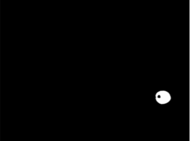

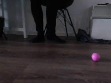

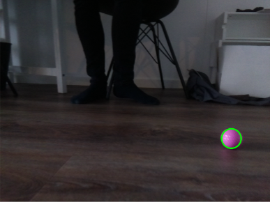

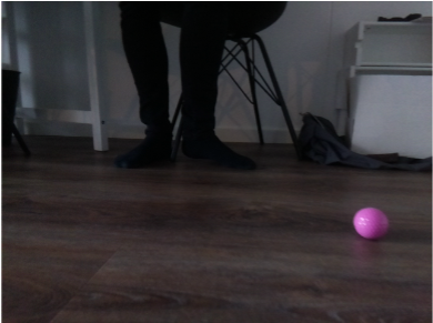

For object detection, a pink golf ball is used. The implementation includes coordinate transformations. The photos are captured by the RPi camera, the frame is received in the format ofcv::Mat. The first step is pre-processing the image, for which the medianBlur OpenCV function is used. It implements a median filter, which smooths an image using a predefined (k size×k size) aperture. Afterwards, the original RGB image is converted to HSV using the cvtColor function. By this, the pink colour can be easily detected. During operation, the lighting may vary, which changes the detected color of the ball. Instead of determining an RGB range, it is better to use the HSV description for this purpose, as only the hue range has to be modified to define the pink range between red and blue. The saturation value defines disparity from white, and the value value defines how close it is to black. After defining the range, a mask is implemented to highlight only the object on the image. For this, the inRange function in OpenCV is used. The mask creates a black and white image, which provides a good starting point to try to estimate the diameter and the origin of the detected circle. To remove the unwanted noise (appears as white dots in the black background), opening morphological transformation is implemented, which is an erosion followed by dilation. Next, a Gaussian blurring is used for smoothing. Finally, the function HoughCircles is applied, which is especially for feature detection. It finds circles in a grayscale image using the Hough transform and returns their origin in pixel coordinates (top left corner is the origin of the pixel coordinate system) and the radius of the detected circles in pixels. Several attempts are made with fit Ellipse, but the Hough transform turns out to be more robust. Morphology removes the unwanted area, thereby protecting the Hough transform to detect two circles which ends up in an erroneous distance and angle result.
Original image
Median blurring
Mask After opening morphology Gaussian blurring Circle Hough transformationCoordinate transformation
The output of the Hough Circles is a structure containing the origin and the radius of the detected circle in pixel coordinates. These values have to be transferred to the robot coordinates system to be able to perform the maneuvering. The knowledge on the ball is applied to determine the distance between the ball and the camera. The detailed notation is described that will be used in the upcoming equations. By using the known diameter of the ball, we can write

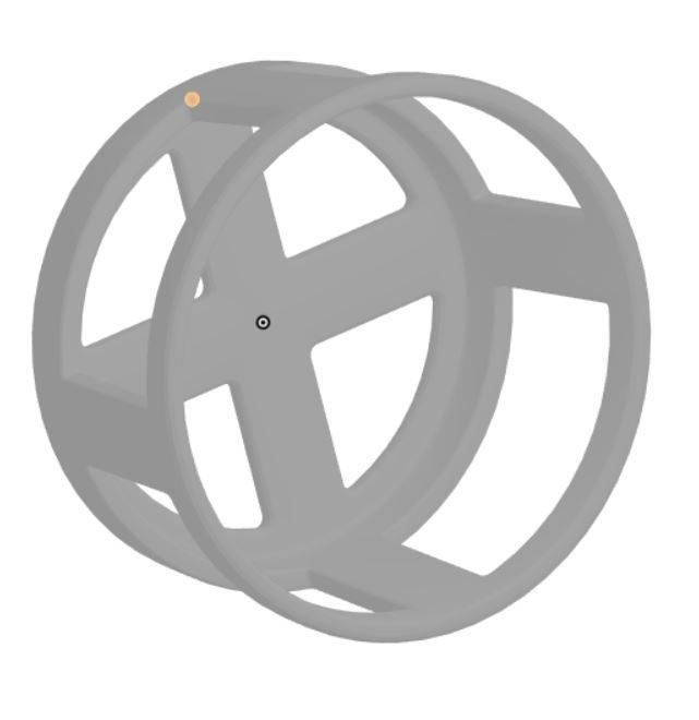

After achieving an accurate estimate of the object position, a mission has been built to scan a given area for the object and deliver it to a target position. The robot takes an image at each observation point (red), and as soon the object is detected, it grasp a ball with the help of arm mounted on a servo. Once the ball is in the basket, the robot finds the way back to the track and delivers it to the target. If none of the three attempts for detection is successful, the robot still goes to the target spot and indicates that no ball has been detected by using audio.
