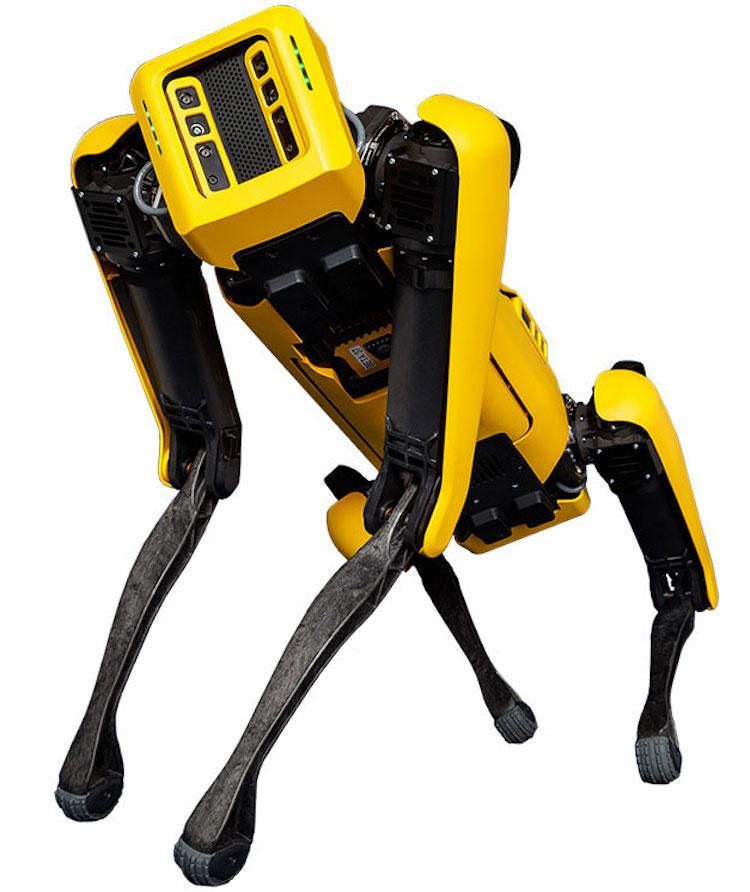

Introduction: Autonomous Robotic Defense System
Throughout the history of engineering, the improvement of defense systems of the most diverse nations has been one of the greatest motivations for technological innovations and for the applications of technical knowledge. Whether in rudimentary or sophisticated tools, the development of these technologies is of profound importance for the future of a given group.
With this in mind, the Autonomous Robotic Defense System project aims at the development of an effective defense system, automated and on a smaller scale.
Being in its essence a prototyping project, the knowledge required for its execution varies from mechanical design concepts, material specifications, components determination and physical integration of the solution, to electronics, the development of circuits and embedded systems, and programming, which fits as one of the skills that most differentiate professionals lately, and will be responsible for the system control algorithm. This project offers a great opportunity for training in the various areas of engineering, because problems of reasonable complexity will be solved using simulation, modeling and programming tools.
