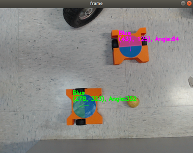

Step 2: Detecting Colors
Using Python and the OpenCV library, we can detect each robot position by checking theirs colors. To install OpenCV, you can check out this link.
After getting OpenCV, we can start thinking of a logic to detect the robots. We are using an yellow ball, a blue and green circle for the first robot and a blue and pink circle for the other one. To detect each color, we have to mask the image captured by the camera, by defining a range of colors in HSV. For that, we use two dictionaries, one for the lower and one for upper colors codes. When you mask the image, everything will turn into black, except the pixels that are between the range you selected. Then you can look for countours in the masked image.

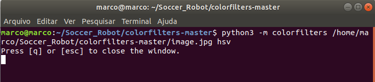

Step 3: How to Find the Range of Each Color
This was by far the hardest part. Finding the best colors for each robot and for the ball took a long time, since we had to adapt the range a lot, mainly because of the back light. The ideal situation is to make this project on a room that doesn't have much light changing, so you don't have to change the colors range.
To make it easier to find the range for each color, we used this code: https://github.com/alkasm/colorfilters. With this, we could easily change the hue, saturation and value (HSV) to find the range that masks everything except the color we want, all we had to do was to save the image captured by the camera and select it. To save the image, we made a short code, called "photo.py".
Step 4: Position and Angle Detection
Now that we know how to mask an image to find a color, we need to find its position. After finding the contour of your color, the position can be easily found with some OpenCV commands, which are shown on "detect_yellow_position.py".
Well, that's all for the ball... But we also need to know where the robots are facing at, so the logic for the robots is a little harder than that.
To check the robots angles, we use 2 colors for each, so we can make a line connecting the middle of the first color to the middle of the second one. With this line and some trigonometry, we can get the angle.
To get all information about the robot, first we need to mask the image captured with the camera, using the range of the two colors of the robot. Then, we can get the position of the robot. After that, we need to make two different masks, one for each color, and find theirs centers. Next step is to calculate the angle, and then you will get all information you need.
