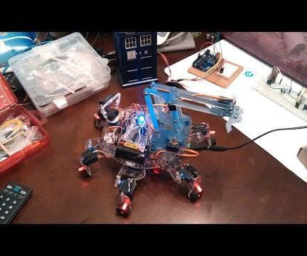

Introduction: Autonomous Tank W/ Robotic Arm(Arduino, Bluetooth)
This Instructables will be explaining the process of building an autonomous Arduino tank with an attached robotic arm to be controlled over bluetooth using the Ardudroid Android application.
Direction is controlled via buttons while the servos of the arm are controlled by sliders in the application that are mapped to the minimum and maximum values of the servo. The total cost of this project is approximately $250-300.
