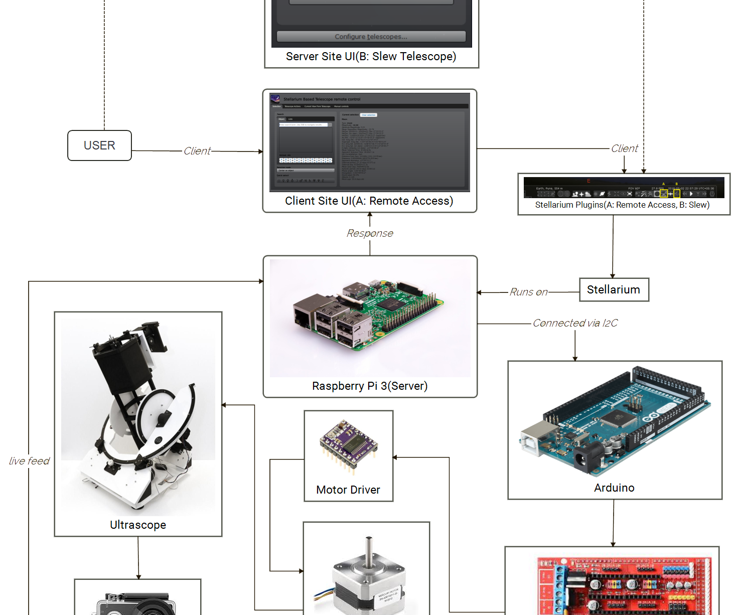

Step 10: Electronics
The Electronics part of autoscope contains following parts
- Ramps 1.4
- Stepper motor driver
- Arduino Mega
- Raspberry pi 3
- Stepper motors(400 steps)
- ATX Power supply(400 - 800 Watt)
- Webcam
- connect Ramps 1.4 board to Arudino by mounting it top
- connect Arudino to Raspberry pi
- connect stepper motors to Ramps 1.4 via stepper drivers
- connect power supply to ramps 1.4
- connect webcam to telescope and raspberry pi
Step 11: Software
We have made website which is integrated with the stellarium plugins through which anyone can access our telescope remotely to view sky at night. This user interface gives user following functions which are as follows
- .These are essential functions required for selecting an object and moving telescope towards it. It includes Selection which is required for selection of appropriate object in sky
- .It provides features of move,sync, cancel followed by conforming the command using run/toggle action. It helps to control the movement of telescope towards selected object.
- .It presents the view as seen from camera of telescope. Thus it presents user a live feed of telescope’s filed of view, as the user would have seen while operating the telescope.
- It essentially provided to track objects and have manual remote control over movements of telescope while tracking the object. It contains features required for controlling movement of a telescope using Joystick
Arudino is is worked on onstep controlling software which is available at below link
https://drive.google.com/drive/folders/1Nq6sSRNcqq6MaAQY2zvht22vsj8oqLcO?usp=sharing
And stellarium is an open source software which will be running on Raspberry pi it can be downloaded from
