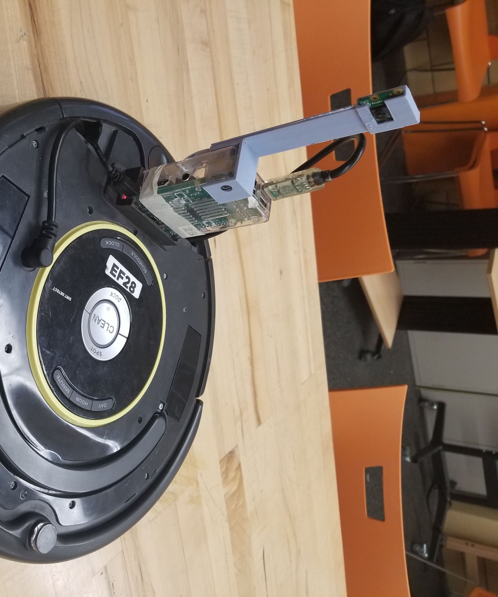

Step 1: Putting It All Together
First of all I would suggest you do a few arduino tutorials dealing with the RF transmitters just to make sure that your parts are working and the wiring is correct. There are plenty of examples available, with the code included (for those of us out there that know little to nothing about C and C++).
Follow the wiring diagrams below to get the arduino and sensors assembled. One thing to keep in mind while wiring up the arduinos is that the data ports I used are not required but recommended.
IF you do decide to change the data ports you use, you just need to define the pins in your code. Personally, I think it's easier to stick with the default ports that the arduino libraries recognize.
And just to be clear, the nano and uno are interchangeable, but I used the nano for the transmitter side of the project to reduce the size of the temperature monitor.
Side note: the green contraption holding the nano is the 3D printed container.
