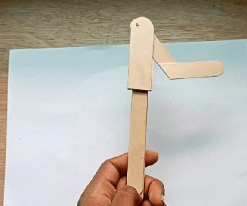

Step 2: Making the Bot Arm and Lever
The arm of this bot is where most of the action is (aside the popping head of course) and the lever connects the thumb gestures of the human controller to the punch throwing response of the bot.
To make the arm, I took a piece of the small popsicle stick and cut it obliquely at the middle. Flipped the pieces and glued it into an "L" shape. I then bored a hole larger than the skewer at the top tip of the arm at its centre through which it'll be fixed into the "shoulder" of the bot.
Later in this guide I glued a dead small button cell each to the tips of the arm to give weight to the punches. I used hot glue here.
To make the lever, I took one of the small popsicle sticks and slide it into the passage in the shoulder of the bot (to be clear, the part being referred to as the shoulder is the boxy part attached to the leg which contains a narrow rectangular passage). Also, later I glued cut tips of small popsicle sticks to the outer sides of the lever 4.5cm from its base to prevent the lever from dropping way too down.

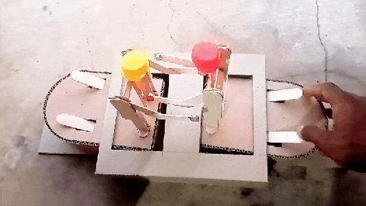

Step 5: Making the Boxing Stage
By the end of step 4, you should have made a unit of the boxing bot. Now, follow the exact same steps from the start to make a second unit.
The stage would house the two boxing bot units and permit the (human-controlled) movements of the boxing bots away or towards each other.
First, cut out the base which is a 25.5cm by 21cm rectangle with smaller rectangles of dimension 14cm by 12.5cm projecting from each of the smaller sides of the rectangle.
Next, cut two pieces of long rectangle of dimensions 33.5cm by 7cm andglue it around the sides of the larger middle rectangle.
For the final piece of cardboard which will cover the stage, cut with the provided template and pass the bots through the two big rectangular spaces in this piece before glueing it in place to the underlying support.

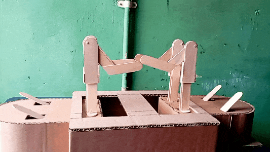

Step 6: Making the Popping Head
For the battle between the bots to be engaging we need a way to show the winner of each round. This mechanism permits for that.
The head of the bots are made to be under tension which is delicately anchored and upon being hit hard enough would pop out of its normal position, shooting outwards. This would indicate the winner of a round if your bot knocks out the head of the opponent's bot. A friend of mine referred to it as giving the opponent's bot an uppercut, LOL.
To make the head for each bot we'll need two bottle caps, a drinking straw, a rubber band, a small popsicle stick, skewer stick, paper clip and hot glue.
I took a bottle cap and cut a small rectangle to one side of it and punched a hole for the bamboo skewer to the other end of it. I inserted the skewer and glued it from the inside of the bottle cap with the bottle cap slanting forwards. I went ahead to cut a 7cm length of drinking straw and unwind a paper clip, straightened it and bent the tip into a loop and then bent the loop forward. The paper clip is then glued to the straw.
The skewer, with the bottle cap attached is passed through the straw and a rubber band was passed at one end into the gap between the straw and the paper clip in the upper part and at the other end the rubber band is stretched and glued on the bamboo skewer. Once the stretched band is released, the bottle cap is lauched up, but not out of the straw due to the attachment of the band. To lock the head, press the bottle cap downwards and pass the loop head of the paper clip into to rectangular cut in the bottle cap to hook the bottle cap against the tension of the stretched rubber band. If and when the cap is hit, the paper clip hook slips off and the cap lauches upwards.
I cut (in my case) a 6cm long piece of small popsicle stick that fits in-between the shoulders of the bot and glued the straw of the popping head to its middle and then glued the piece in-between the shoulders of the bot. Take the second bottle cap and glue it on top of the first one.
I did the same thing but with a bottle cap of different colour for the other bot.
Step 7: Gameplay and Conclusion
The battle requires two opponents (which is why I wasn't able to document a proper gameplay, especially with phone in the other hand for recording), a coin may be tossed to choose which bot will be yours. The bot can be charged forwards and backwards in attack and defense. They can also be moved slightly sideways to deflect opponent's punches in defence and to aim your bot's punches at the opponents head in attack.
It's meant to be a fun make and indeed it was, it's meant to be cheap to make and it was indeed, too.
Overall, I think it's a really nice play toy for kids: robot boxing avatars made with popsicles and cardboard.
