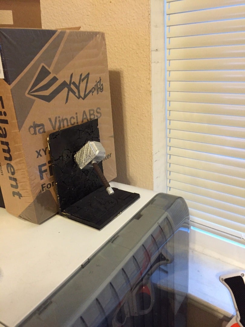

The first thing was to 3D print the bookends. The files come complete so you just print each end. However, you are not done yet. The plastic is too light to hold books. Not to mention it still needs painting. As far as making the bookends capable of holding office books (law books specifically), I had a few options. However, I decided to go with attaching a metal plat to the bottom which extends beyond the bookend and which can hold use the books own weight.

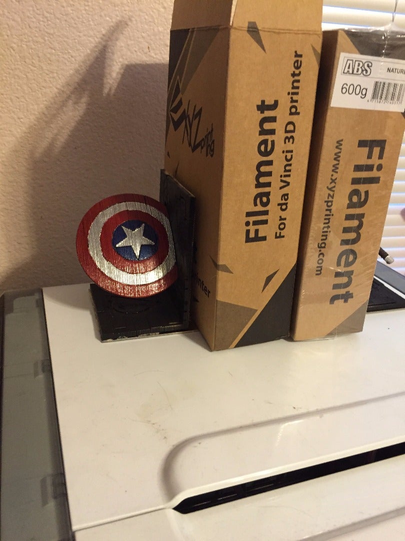

Painting Thor's hammer was pretty easy. Just paint the individual pieces very carefully. Painting Captain America's shield is a lot harder. I determined the best way to paint it was to start from the center and paint outward. I first painted the star in the center. Then used blue painter's tape to separate the color sections. I pained outward, blue, red, silver, then red again.

I then measured and cut 1/16" metal plates to attach to the bookends. I had to score the plates a little in order for the glue to attach. I used some Gorilla Glue to attach the two.

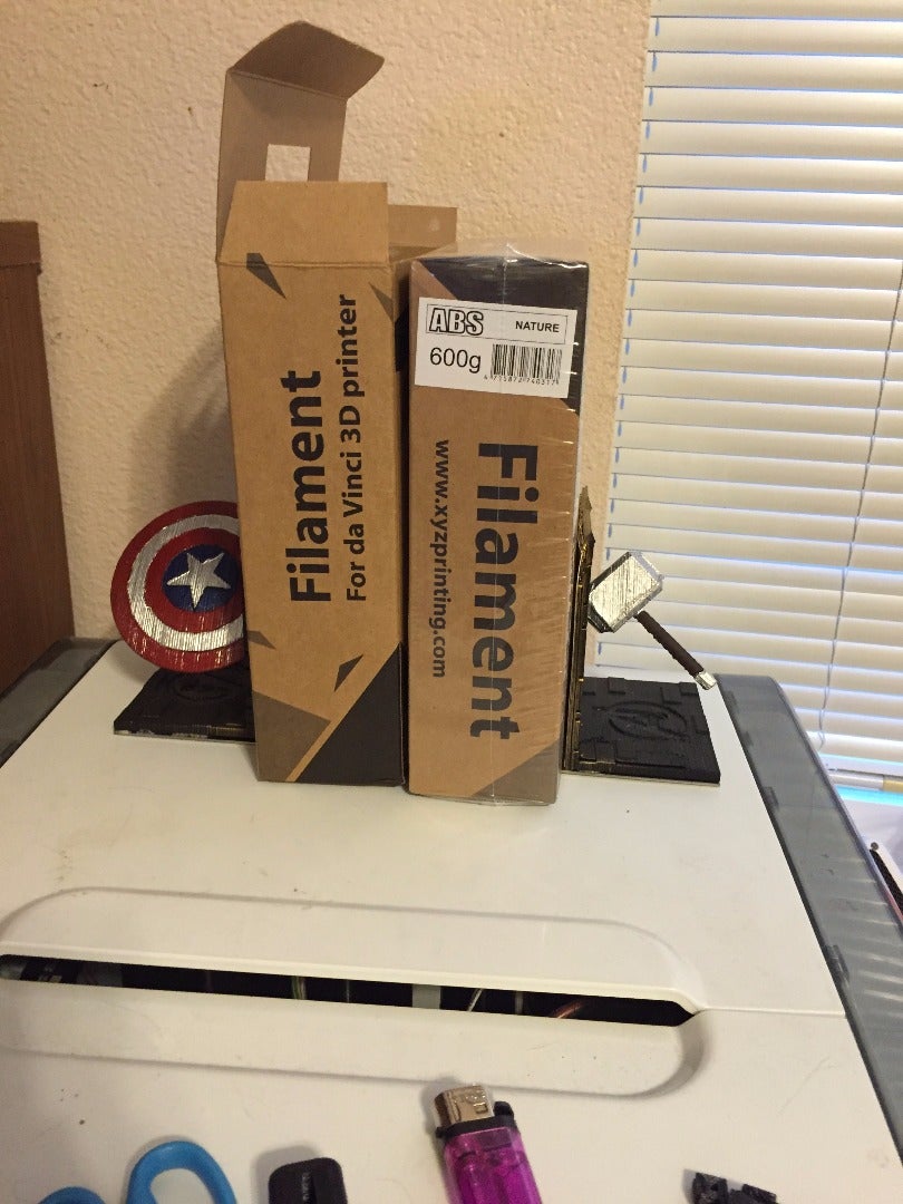

Initial use of the bookends for organizing filament seemed to work very well. Next, I think I'll put in my office and see what people think.
