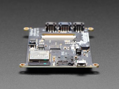

The PyPortal uses an ATMEL (Microchip) ATSAMD51J20, and an Espressif ESP32 Wi-Fi coprocessor with TLS/SSL support built-in. PyPortal has a 3.2″ 320 x 240 color TFT with resistive touch screen. PyPortal includes: speaker, light sensor, temperature sensor, NeoPixel, microSD card slot, 8MB flash, plug-in ports for I2C and 2 analog/digital pins, 3D files for custom enclosures / lanyard fastening. Open-source hardware, and Open-Source software, CircuitPython and Arduino. The device shows up as a USB drive and the code (Python) can be edited in any IDE, text editor, etc.
Pin-mapping
The ESP32 uses the SPI port for data, and also uses a CS pin ( board.ESP_CS or Arduino 8 ), Ready/Busy pin( board.ESP_BUSY or Arduino 5 ), and reset pin( board.ESP_RESET or Arduino 7 )
We also connect the main RX/TX UART to the ESP32 - on Arduino that's Serial1 and in CircuitPython use board.RX and board.TX.You can also connect to the ESP32 RTS pin (used in some serial contexts) on board.ESP_RTS or Arduino 51. The ESP32 GPIO0 pin for bootloader enable is connected to board.ESP_GPIO0 or Arduino 6

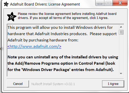

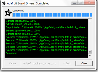

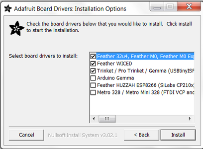

Step 2: Install Drivers (Windows 7 & 8 Only)
  • Download and run the installer from the GithubRun the installer! Since we bundle the SiLabs and FTDI drivers as well, you'll need to click through the license.
  • Select which drivers you want to install, the defaults will set you up with just about every Adafruit board!
  • Click Install to install it

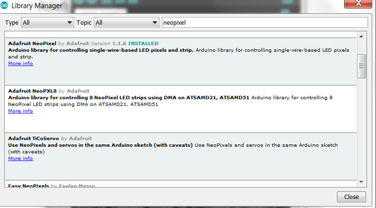

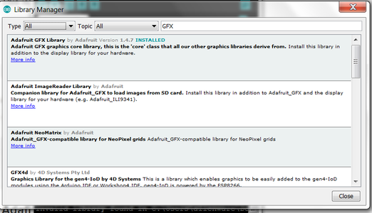

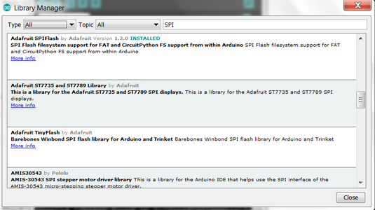

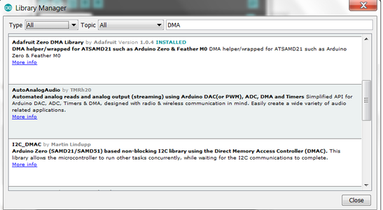

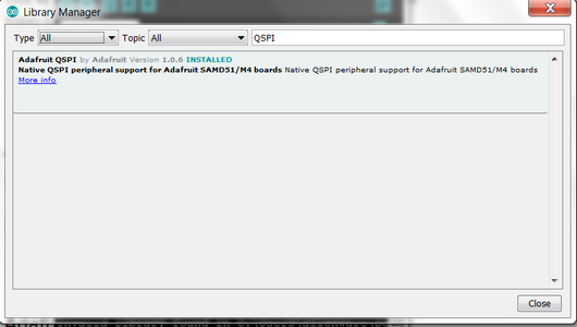

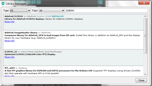

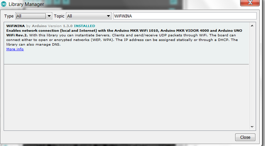

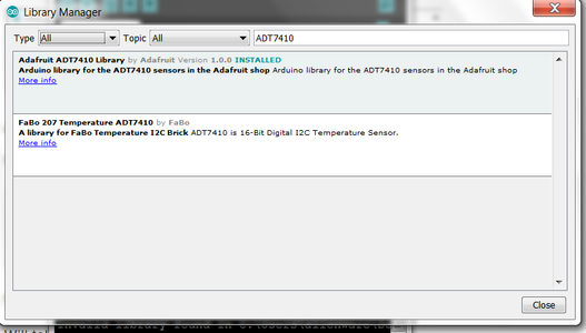

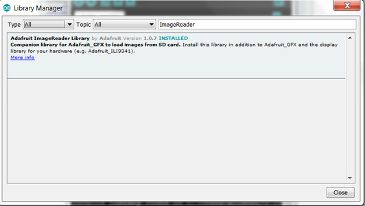

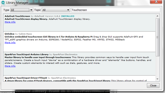

Install Libraries
As the Adafruit PyPortal has all the circuits in-built, it requires several library to function. Open the Library manager and type the "Lib name" and click install. Some Libraries are Adafruit NeoPixel, Adafruit QSPI, Adafruit SPIFlash, Adafruit Zero DMA, Adafruit GFX, Adafruit ILI9341, Adafruit Touchscreen, Analog Devices ADT7410, WiFiNINA, Adafruit ImageReader.
