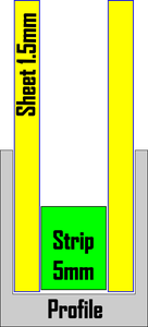

In my trolley the sandwich panels consisted of 2 aluminum sheets glued to some type of foam. As I planned to turn this into a barbecue and light a small fire on the inside of the cart this didn’t seem to be the best material for the job. The heat will affect the consistency of the foam and probably also add some unhealthy flavor to my meals. I therefore decided to remove the sandwich panels and replace each with 2 separate sheets of aluminum. To clamp the 2 sheets in place and make it all fit snugly (while capturing some air for insulation at the same time) I simply wedged some aluminum strip between the sheets. The thickness of the strip depends on the aluminum extrusion and the thickness of the sheets. In my case the aluminum extrusions were made to host 8mm thick panels (or for those of you that prefer a measurement system based on the length of medieval European body parts: that’s roughly 5/16 inch). My 2 aluminum sheets are 1.5mm so I had to use a 5mm strip to fill the gap.

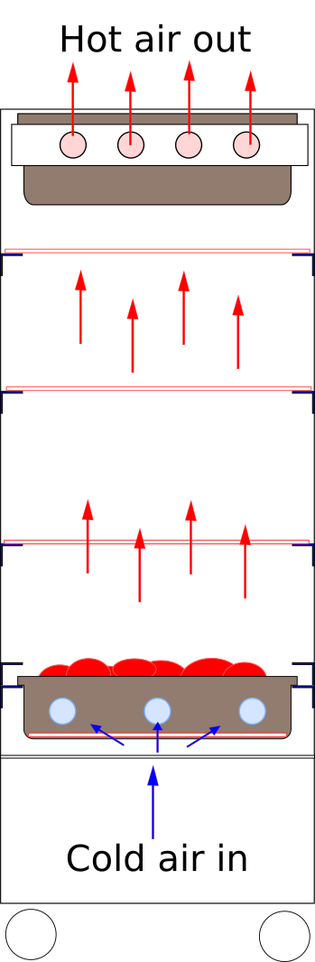

In order to regulate the temperature, a vent is required near the top for the hot air and smoke to escape and one near the bottom to allow oxygen in. The one at the top I created from a piece of L profile and a strip that slides on it. Both have the same hole pattern drilled into them (keep as much or slightly more room between the holes than the diameter of the hole so you can close it entirely, a step drill is a perfect tool for the job), the strip needs to be at least the diameter of the hole smaller than the profile and requires a little knob to open and close it.
The lower vent is nothing more than a wide strip of aluminum that pivots near the rear wall and closes a hole in the bottom.
Oxygen is required for the coals to burn, the air surrounding the coals heats up and rises. By allowing the hot air to leave the smoker at the top, cold air is sucked in at the bottom to fill the “gap” caused by the escaping air which results in air circulation. I used a Gastronorm (also known as Gastro-Norm) bin as fire box. These gastro norm bins come in various sizes and one of them fits nearly perfect. By drilling holes in the sides of the bin (I highly recommend using a step drill to create the holes in this thin sheet metal) and placing some wire mesh on the bottom of the bin I ensured that the only way for the air to travel from the bottom to the top of the smoker is around the coals.
For grates you can of course go shopping in the cooking supply area of your favorite store, you will probably need a hacksaw or angle grinder to make them fit. I used some stainless-steel mesh that I cut to size. Expanded metal is probably the easiest to get a hold of if you want to make the grates yourself. The grates rest on aluminum L-profiles that I connected to the walls using rivets. I added a extra set of profiles just above the fire box and bought a set of ceramic stones typically used in gas grills. They assist in creating a even temperature around the smoker and their thermal mass also helps heating the chamber up after opening the door during the cook.
The top of the smoker is nothing more than a aluminum sheet with a hole the size of the gastro norm bin. To cut the hole simply place the bin upside down on the sheet, mark the outside of the bin and then use that line to cut a hole a few millimeter smaller such that the bin is able to hang in it. In some of my pictures you'll see 2 smaller bins hanging in it.
