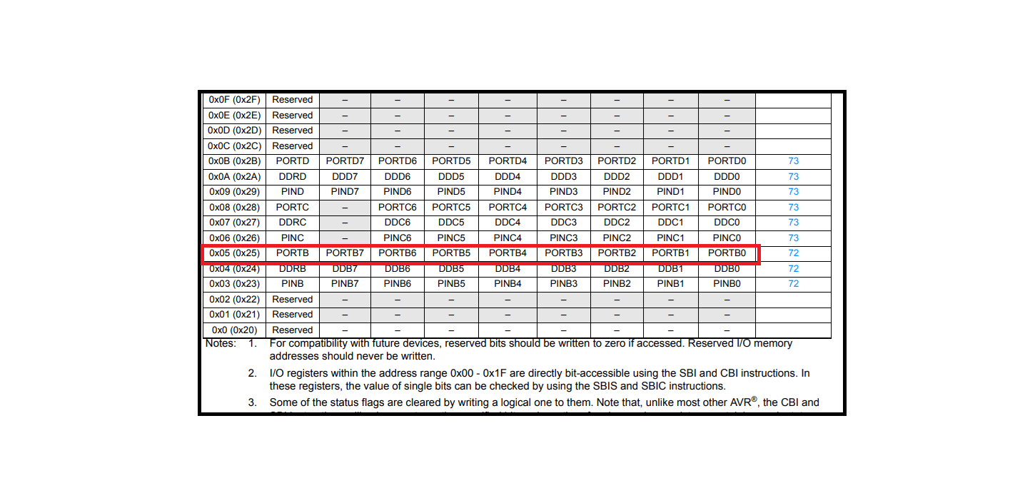

For example at arduino to write a port to high or low need to write one to bit of register.

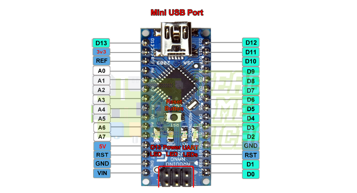

For example if want to make PORTB0 to 1 (PORTB0 is equivalent to D8) need make 1 the bit 0 of register 5
So if a bit 0 of register 5 is set to 1 and all remainder is set to 0 ... in this case PORTB0 that coresponding at D8 will be on. The onboard led is D13 that corespond on PORTB5.
So again...
If want make LED ONBOARD ON !!! need to set to 1 bit 5 on register 5
In assemble code this mean SBI 5,5 ... so first 5 is register and second 5 is a bit
Also if declare:
.equ PORTB = 0x05
You can write:
SBI PORTB,5 or SBI 5,5 ... is same !!!!

SBI 5, 5 Breakdown:
Let's break down how SBI 5, 5 is translated for the ATmega328:
SBI A, b        > Machine Code >  1001 1010 AAAA Abbb
  • First Byte (Opcode):
  • Binary: 0b10011010
  • Decimal: 154
  • Hexadecimal: 0x9A
  • Second Byte (Register and Bit):
  • A (register): 5 in binary is 0b101
  • b (bit): 5 in binary is 0b101
  • Combined: 00101 (register) + 0101 (bit) = 00101101
  • Binary: 0b00101101
  • Decimal: 21
  • Hexadecimal: 0x2D
Therefore, SBI 5, 5 translates to 0x9A2D in machine code.
