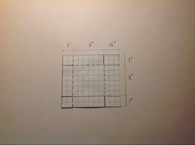

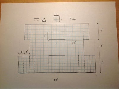

The organizer is built out of flat sheets of cardboard folded and cut so that it can be formed into the desired shape and taped into place. In the diagrams above the scale is in inches and I did my best to provide all the measurements that are needed. The first picture is the main body and the second is the drawer that slides into it. The dotted lines on the diagram represent where the cardboard needs to be folded while the solid lines show what needs to be cut.
First based off of the diagram I carefully replicated it onto the top of the box starting at the lower corner. I used the marker and the ruler to measure and place a dot where each corner should be. Then I went back and drew lines between them so I would know exactly where to cut and where to fold.
