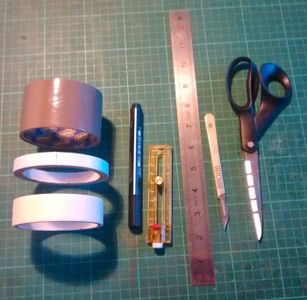

Step 1: What You Need
Ok first you need to get your equipment and materials together. You should be able to find all the things needed around your house.
  • Cardboard: Get a large flat box such as a TV box or one used to flashback furniture.
  • Tape: Masking tape for the ouside painted areas and Packing tape for inside strength.
  • Adhesive: White glue, Prit-stick or Double sided tape.
  • Paper: Flipboard paper or wallpaper lining paper works great.
  • Paint: Poster Paint as its cheap and dries quick. Black, White, Red and Yellow
  • Tools: Cutting board, Craft knife, Compass, string, Chalk, Marker Pen, Ruler/Tape Measure, Paint Brush
