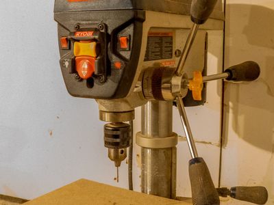

Step 10: Drilling the Hole in the Handle
I prefer to use a ¾ inch Forstner bit in a drill press for the holes as this combination cuts very cleanly. Note that I always have a sacrificial board underneath my bread board to prevent chip-out on the bottom of the hole. Even with a sacrificial board (particle board in this case), ensure that you have an unused part of the board underneath. If you continuously use the same spot, your will still get chip out, sometimes some major chip out. I was so pre-occupied with taking the photos for this Instructable that I forgot to move the sacrificial board. This will have to be compensated for in the sanding. Once again, you can carefully use a hand drill to complete this step, but you will still need a sacrificial board underneath. A Forstner bit may be too much for a hand drill, but who knows: you may have really strong wrists to prevent the drill from twisting. I have never used a regular drill bit for this step.
