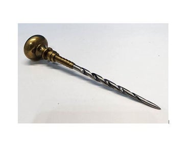

I have to say that the brass handles really give a nice feel to these tools.
I grind down drill bitts and add handles to them to use as awls
the awls I am showing in this instructable are using solid brass door handles.

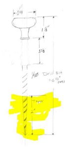

Awl
Drills
  • 3 1/2 inch length by 13/64 inch diameter
  • 6 1/4 inch length by 1/4 inch diameter
Handles
Solid brass door handle / knobs
  • 1 1/8 inch height by 1 1/4 inch diameter
Embellishments
  • brass hose barbs
  • Stainless steel spring

I grind at an approximately 20 degree angle.. in relation of the drill to the grinding wheel.
The end taper is a preference -- but you will need a point.
You could also put some flats on the end if you need, I do not
So grind to a preferred taper.

Step 4: Press Handle on Drill Awl and Add Embellishment
Add a little gel glue in the hole of the handle
Holding the awl in the bench vise I tap on the handle / awl
Drilling the holes 1 to 1 did not take a lot of force to press on.
Add embellishment by sliding it up the awl
add a little gel glue on the embellishment to hold in place.
