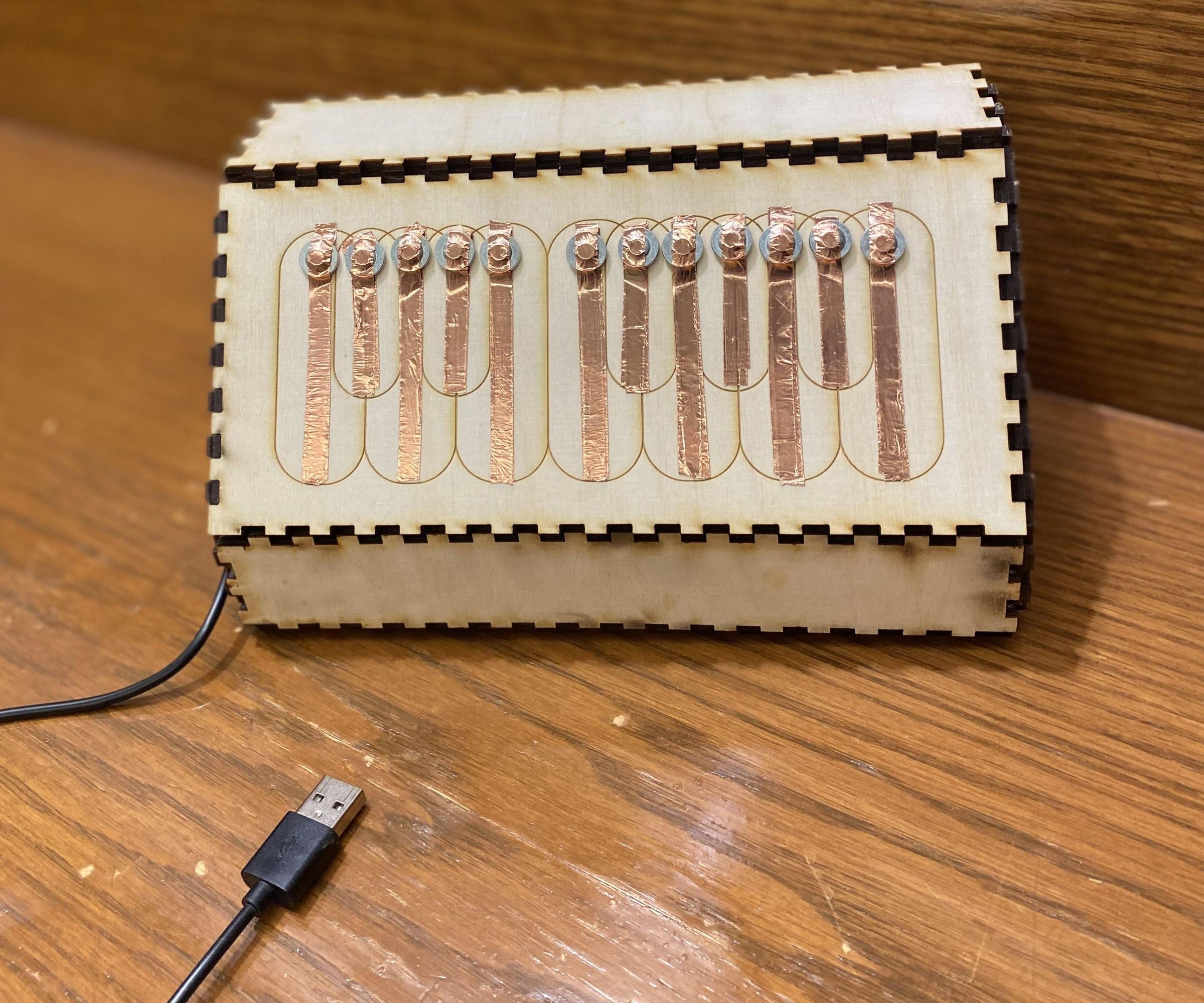

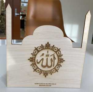

Step 2: Assembly
The front has been designed by using Adobe Illustrator and represents a mosque. The design for the box behind was from boxes.py and uses a living hinge. Additionally, a hole for the speaker has been created. All the electronics are in the box. The different parts have been glued together.
