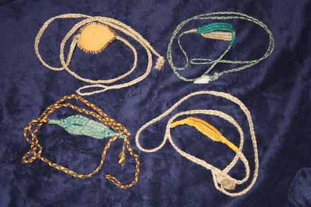

One of the most interesting tools, in my opinion, used by paleo hunters was the sling. Unlike other hunting implements, it could be created on a moment's notice with very little effort and utilizing supplies that were available regardless of where they were. They were also extremely portable. Tied around the waist as a belt, or wrapped around the wrist, a sling made a perfect secondary weapon, in the event that the hunters primary tool became damaged or lost. Slings were extremely effective for hunting, however they required quite a bit of practice to master, tho an experienced slinger was known to take down animals as large as a wolf. With the advent of the bow, the sling fell out of favor, only showing up, occasionally, on the battlefields in great numbers as a cheaper alternative to archers, however it's general use as a hunting implement was rarely employed.
These days, slinging has become somewhat of a sport, with a loyal following that share designs and innovations mostly in online forums. There are even clubs that hold slinging competitions that test the slingers construction skill, and prowess with their sling. It's also becoming popular in dog parks, where owners are using slings to achieve more distance when throwing balls for their pets.
I've used a variety of different materials in sling making including hemp, jute, wool, alpaca fur, leather, even gathered dog hair, if you can imagine that. For this instructable, I'm going to concentrate on my favorite material which is deer hide. Deer hide has the advantage of being one of the strongest, lightest leathers available, allowing for finer string making, while retaining enough strength for an effectively powerful sling. It is also, somewhat, elastic, and unlike the rigid qualities of hemp, can give a bit of 'spring' to your finished sling, if only improving it's power somewhat. If you don't have any leather on hand, it isn't a problem. This instructable can be created with any material you have readily available, even and including creating your own. If you would like to start from scratch, I cover string making in my instructable on net weaving here;

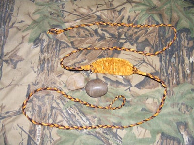

Step 2: Cutting Your String
You're going to need to make roughly 50' of rope for one sling. This isn't as hard as it sounds using one 12x12" patch of deer hide leather. To start, cut off the corners to round your leather patch. You can use a sharp knife, but the entire process is 100x easier if you use a wheel cutter. The pink and purple model you see in the image was purchased from a local dollar store. Please don't judge me on it. Now, start cutting a strip, roughly 3/16"-1/4" wide from the circumference of the patch, rotating it as you cut. Keep cutting around and around, as the patch becomes progressively smaller, trying to maintain the width of your string as much as possible. Don't worry if you cut too wide or too thin. You can cut out pieces that are too thin and splice the string back together using the leather glue without affecting the strength of your sling. If all goes well, this should provide you with roughly 60' of usable string.
**I find that wetting your leather prior to cutting actually makes the process easier. It's not necessary, but you'll find your string will have better consistent width if you do.

Step 4: The Finger Loop
Line the three strands together then, folding them in half, find the center (image 1). Once you've located the center, measure over two finger thicknesses and tie off the strands. (Image 2). This should create one end that is longer than the other.
Now, clamp (or tie) down the shorter end to a solid surface, then separate the three strands of the longer end. Begin braiding the three strands (image 3) by using a system of left over center, right over center, left over center, right over center etc. until you have a braided piece that is roughly 3" long. Be certain that your braid is nice and tight. Don't be afraid of using force as the deer hide should be more than strong enough to handle it.
Once you've finished your braid, fold the section into a loop, separate the strands into three bundles (image 4), pairing the left strand with the left strand, the center with the center and the right with the right.
