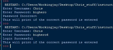

To begin coding the logon I opened a new python file in IDLE and saved
it as logon.py Building small snippets of code separately and combining them later is easier to juggle and troubleshoot.
Check the notes in the screen shots above for details and see how the input is taken and used.
The python example code in the above pics was my first attempt at a logon input.
Pic 2 Note how the If and else functions work.
I added the final print line after the if, else, to monitor if the python program was functioning as I want.
It clearly is not exactly what I intended as the last line get printed if the correct password is entered or not.
As far as pure function of the code what I want is for this piece of code to ask for the correct password an undetermined number of times until the correct password is entered. I need a loop. The while and do while commands do just what I am looking for.

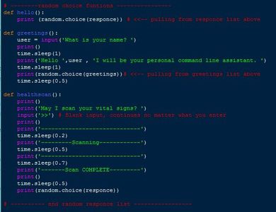

Now you are a python programmer but you need a kick-start. This step just showcases sample python programming functions that I use in my Baymax CLI function dictionary as available commands that 'Baymax' allows me to access from the command prompt.
The first pic shows small functions that call other windows programs to open things.
In the command prompt typing 'google' will open a new tab in the default web-browser to the google.com. Typing 'wordpad' and 'sketchup' opens a a new word pad file and google sketch up, respectively.
The 2nd pic above shows the 2 lists of available responses and greetings. The 3rd pic shows how I am accessing these list items randomly so the Baymax programing does not repeat the same things over and over, this way he can showcase his personality. :-)
