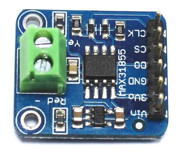

MAX31855 module with a thermocouple

Arduino <-> Temperature sensor
4 <--> CS
14 <--> DO
15 <--> CLK
