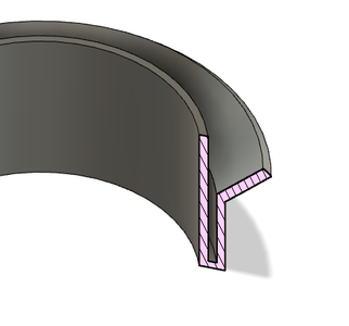

With the diameter of my silicone band calculated I used Fusion 360 to create a mold that I would 3D print to cast the silicone in.
Step 2: 3D Print a Band Mold and Prepare It
I created a band model with only 1mm wall thickness. I hindsight I should have made it at least 2mm thick, if not more. I took the Fusion 360 model and 3D printed it. I had added a funnel type feature to help get the liquid silicone into the mold.

I have included the stl file of the mold as an example. But as mentioned, I would make the band thicker.

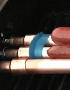

Step 5: Construct the Rollers
As noted previously the rollers are 3/4 inch diameter copper water pipe.
The pipe was cleaned with SOS pads (Soap On Steel wool) under hot water. I needed to remove al the surface printing on the pipe; and who knows what germs live at Home Depot?
The pipe was cut into three 2 ft lengths. I allowed quite a bit of space between the copper pipe fitting and the wall of the barbecue in order to allow all-thread rod sticking out of each end of the pipe to be slid into the mounting holes in the sides of the BBQ.
It is amazing how perfectly the 1/4" x 5/8" all metal bearing [1/4" (hole in the center of the bearing) x 5/8" (overall diameter of the bearing)] fit into the 3/4" x 1/2" copper pipe reducer. The bearing slid into the 1/2" side. And he 1/4" all-thread rod slipped wonderfully through the bearing.
Going from one end of the roller to the other: a 1/4 x 20 course nut, followed by the bearing, then the 3/4" to 1/2" copper reducer, then the 3/4" copper pipe, then the other end's reducer, bearing and nut. No need to solder the copper pipe to the reducers or to anything else, it all fits snugly sandwiched all together on the all-thread rod with the nuts holding the assembly together.
The pipe in the center freewheels nicely on the bearings.
Step 6: Mount the Rollers Into the BBQ
My BBQ already had 4 holes on each side of the BBQ.
I chose to increase the diameter of two of the existing lower holes with a 17/64" drill bit to accommodate the 1/4 in all-thread rod. I had to drill a third hole on each side to accommodate the third roller.
Don't forget to slip your Silicone Bands over the ends of the rollers before you mount the rollers into the sides of the BBQ.
Mount the all-thread into the mounting holes with nuts and washers.
