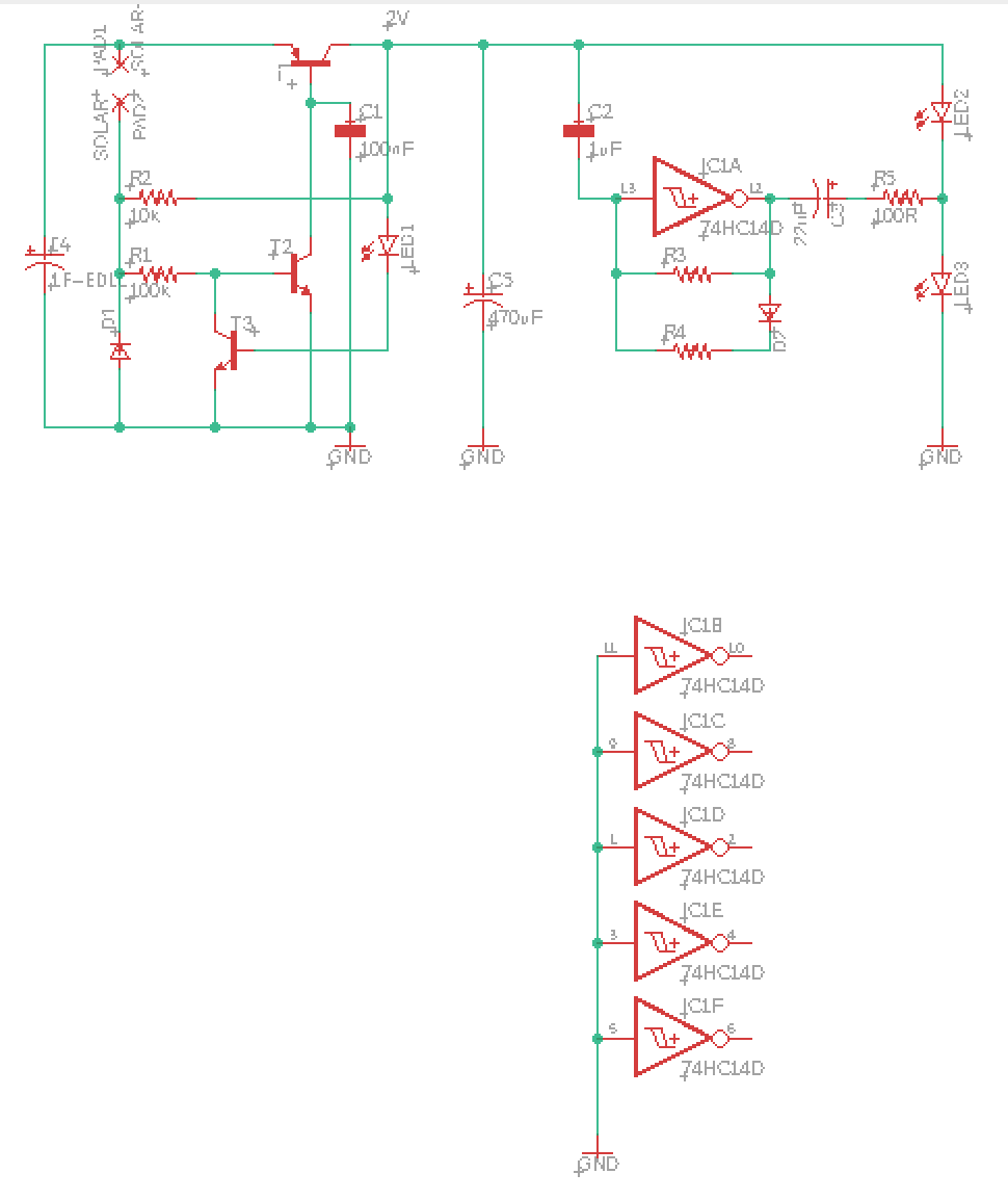

Step 3: Drawing the Schematic
Once I was sure my design worked on the breadboard I begun drawing up the schematic in my PCB designer of choice, Eagle.
Placing the components
First step was placing all the components I knew I needed (I missed a couple the first go around but just having the important components where they need to be is the most important part). All of the basic, surface mount components such as the SOT-23 transistors and 0804 resistors/caps came from the standard Eagle libraries.
I kept some of the resistors and capacitors (namely R3, R4, R5 and C3) as through hole components such that their values were easier to change and experiment with for different effects. R3 and R4 dictate the time between the flashes of each of the large, red LEDs and C3 and R5 dictate the brightness and length of each flash. These too, all came from standard Eagle libraries however you may have to do some measuring or snooping on datasheets to see which capacitor footprints you need.
LED1 is used only as a reference to regulate the output voltage of the solar engine (see http://solarbotics.net/library/circuits/se_noct_SI... for more details on how this works). Hence it could have just been another small surface mount component but I decided to opt for a 3mm LED again to simplify things if I wanted to change it out for different regulator voltages. LEDs 2 and 3 are the large, 10mm red LEDs that will flash in the final design and all of these footprints can be found in the basic Eagle libraries also.
The pads for the solar panel as well as the surface mount 74HC14 were also pulled from the standard Eagle libraries.
The 1n4148ws surface mount diodes I downloaded an external library for which worked well.
Similarly I could not find a footprint for the 1F capacitor in the standard libraries however I did find it in a Sparkfun capacitor library. Unfortunately, although the external footprint of this part was correct, the holes for the leads were much too small and were almost too small to drill out larger. Fortunately, as you will see in later steps I got very lucky and this was an easy fix. It is always hard to see all of these minor details before the board has been manufactured and as you will see I did make a few more mistakes.
Connecting the components
Connecting the components in Eagle went off without a hitch however there are a few things to note with the 74HC14 chip. Firstly we must ground the input of each of the other 5 gates which you can see in the final photo.
We also need to connect the chip to a GND and VCC net to power the chip. Luckily in my schematic I included a GND however I forgot to include a VCC which meant after routing that my chip's VCC pin was left floating. Another issue I needed to fix later down the line.
Step 4: Final Component Values
Following are the valued I found to work best in the end, and some information on why:
R1: ~100k
R2: ~10k
R3: 2.2M (can be a little smaller for faster beats. This value got me a BPM of ~38 which is quite slow even for a sleeping BPM however it is calming, still very much reads as a heart beat, and it extends the amount of time the circuit can flash for each night)
R3: 470k (this value changes the time between the first and second flash, I found ~500k to work great)
R5: 100ohm (not even really necessary however it makes the each flash a little dimmer and linger a little longer, it also probably extends the life of the LEDs tho that is unlikely to be a concern)
C1: 100nF
C2: 1uF
C3: 10uF (tho 22uF seemed to work just as well, as long as it has enough time to charge up, in theory the higher this capacitance the brighter and longer each flash can be however it will use more power)
C4: 1F (I have yet to test this circuit in winter or during an overcast day as its pretty sunny down under at the moment however with this panel and a 1F capacitor the circuit is fully charged before midday and I can almost fully charge a 7.5F capacitor off the same panel so a larger capacitor is not a bad idea)
C5: 470uF (this capacitor can be much smaller or even omitted however when it is, the blue reference LED on the SIMD1 regulator will light after every pules due to the excess current dumped onto the power rails, through the LEDs, by C4 so I just chucked a really large capacitor on to rid any artefact of this.

3. Missing power connection for the 74HC14
Also mentioned previously, I never made a connection to the 74HC14's VCC pin.

Step 19: Fixing the Missing Connection
This is where I realised I was missing a connection to VCC of the 74HC14.
To fix the missing connection to VCC I cut a small length of enamelled copper wire to connect the 74HC14's VCC pin to the nearest VCC point I could find (in this case the filter capacitors leg). I felt that this was the cleanest bodge wire I could come up with and luckily I don't feel it is an eye sore in the final design.
