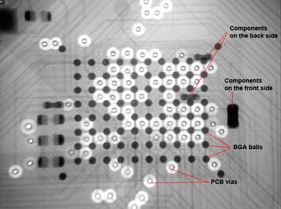

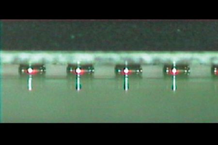

After the board reaches room temp you may remove it from the bga rework machine and supports. Remove all tape from the board and proceed to examine the solder balls. Proper inspection requires the use of an X ray machine or a Scope. Depending on the type of flux used an Ultrasonic bath may be needed to remove any harmful chemical residues left on the board. If using Kingbo this step is not necessary as it is a mildly active no clean flux. This means that is not corrosive and the residue is safe underneath the chip.
