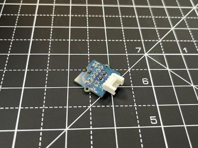

Step 7: Circuit Diagram:
I used very minimal components to make this sensor. The main problem in designing is that the sensor works on 3.3volt logic and my interfacing microcontroller Arduino works on 5volts. That’s why I have to use a logic level convertor to set up a connection via I2C protocol. In BH1750 using some pull up transistors on SDA and SCL lanes I got the perfect circuit. With some capacitors on the power lines to filter the input voltage.
I used 4.7k pull ups to get match the signal with microcontroller, in addition a MOSFET on SDA pin and a diode on SCL pin is required. Grove 4 pin connector is mounted on the PCB to connect directly with grove shield. And an external volt regulator to give a constant 3.3volt to the sensor.

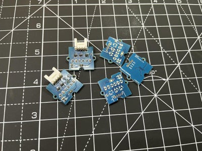

Step 8: My Grove Sensor Design:
I designed this PCB using Altium and then exported as Gerber, you can download the all files including schematics from here. And then quote my sensors SEEED fusion service. After 10 days I received these boards and working as commercial one. Now it is your turn to innovate a new sensor or modify the existing ones.

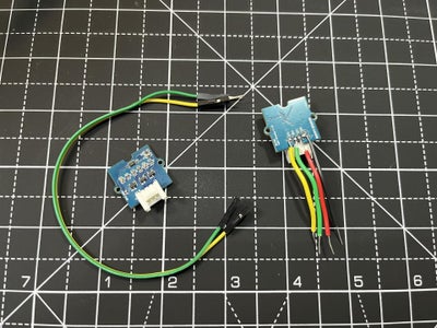

Step 9: Detecting the Address:
BH1750 comes with dual address compatibility option. By default, address pin of BH1750 is pulled down to archive an address 0x23 but by giving a logic high signal of 3.3volts can change the address to 0x5C.
Now connect the Arduino using this schematics with BH1750 and upload the I2C scanner code from examples under I2C/ wire library. Open the serial monitor and get the address of your sensor.

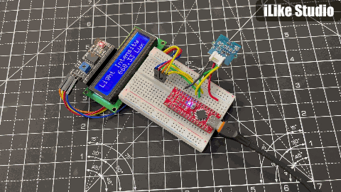

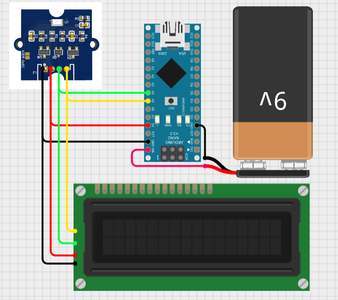

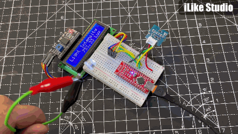

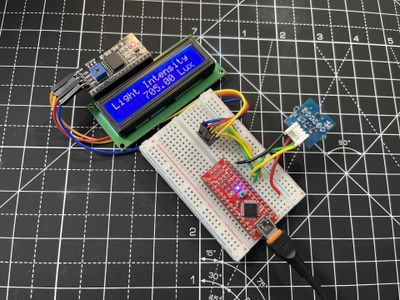

Step 10: BH1750 With 16X2 LCD:
Then I tried a code with 12C liquid crystal to give a better user interface and to turn it into a real-world LUX gauge. I follow the connection of the schematics given below, both of sensor and LCD can be interfaced using same I2C port because of having different address.
VCC to 3V3 or 5V
GND to GND
SCL to A5
SDA to A4
Step 11: Code for 12C LCD:
#include <BH1750.h>
#include <Wire.h> // Library for I2C communication
#include <LiquidCrystal_I2C.h> // Library for LCD
BH1750 lightMeter;
LiquidCrystal_I2C lcd = LiquidCrystal_I2C(0x27, 16, 2);
void setup() {
Wire.begin();
lightMeter.begin();
lcd.init();
lcd.backlight();
lcd.setCursor(0,0);
lcd.print("BH1750 Test");
lcd.setCursor(0,1);
lcd.print("Please wait...");
delay(3000);
lcd.clear();
void loop() {
lcd.clear();
lcd.setCursor(0, 0);
lcd.print("Light Intensity ");
lcd.setCursor(5, 1);
float lux = lightMeter.readLightLevel();
lcd.print(lux);
lcd.print(" Lux");
delay(2000);

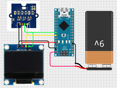

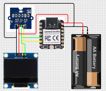

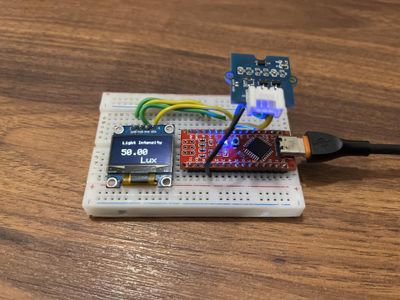

Step 12: BH1750 With OLED Display:
Using the same I2C method I interfaced one more display. This is SSH1306 0.96 inch OLED panel working on a 0x3C address.
Make all the connections using this schematics and then upload the Arduino code given below:
Step 13: Code for OLED:

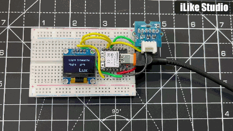

Same code can be used to interface the sensor with XIAO ESP32C3 module. This is the lowest possible formfactor of esp32 MCU. BUY XIAO ESP32C3 from here.
