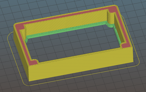

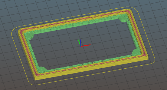

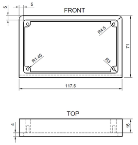

Step 1: 3D Printed Case
Case of my wendlerClock is made of one piece to make things simple. I suggest printing the case with the front set down (see attached picture) with support material to make the front piece look nice and sharp.
You can also print the case with the back set down and then no support material is needed.
Nozzle: 0.5mm
Layer height: 0.25mm
Infill: 10%
Support material: YES
