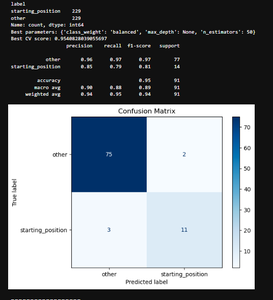

The resulting data is naturally unbalanced, but I tried to include enough “edge cases”—for example, frames where the starting position is just beginning to transition into movement—so the model would handle real-life variety.

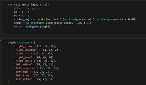

Angles, not raw key points: Instead of feeding raw positions, I calculate joint angles in 3D (elbows, knees, hips, etc). Why? Because the “pattern” of movement matters more than your exact body shape or camera angle.

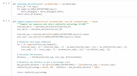

Derivatives of angles: To judge not just where you are but how you’re moving, I analyse the rate of angle change (so the system focuses on “doing the thing right”—form and coordination).
Dynamic Time Warping (DTW): People move at different speeds. DTW lets me compare your drill to a tutorial example—even if you’re a bit slower or faster—by aligning the sequences.
Classification Model: The main AI model is a binary classifier (Random Forest, with SMOTE to handle class imbalance), trained to spot when you’re in the correct starting position. For this first version, I picked three drills with the same starting position (for simplicity), but you can expand to more in the future!

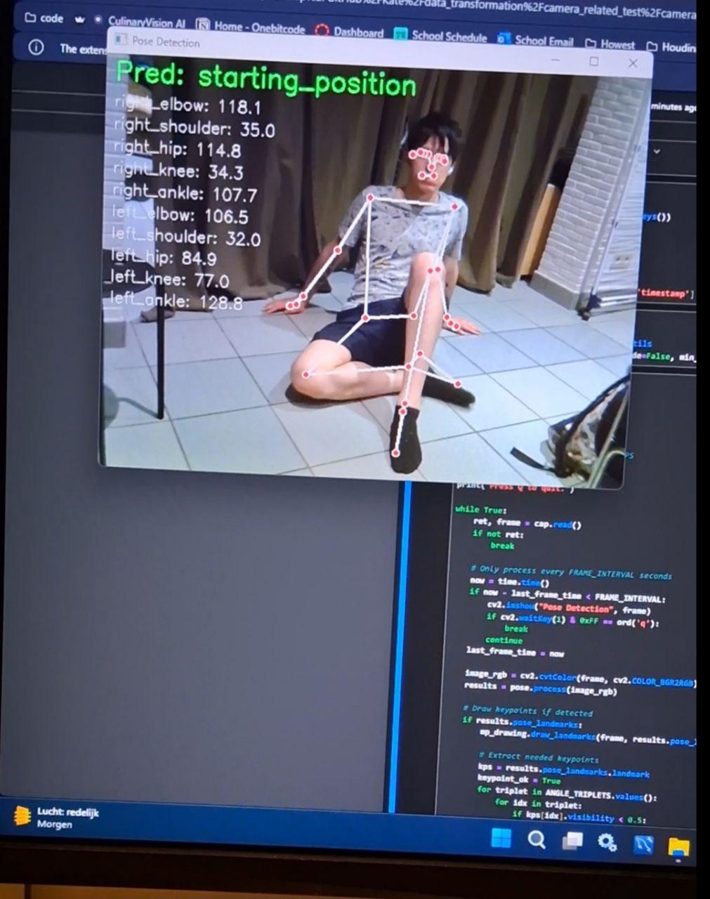

  2. Live camera feed starts; data collection begins when you press the button (LED turns yellow).
  3. Stand in the reference starting position. When detected, LED turns green, and reps are counted/synced with tutorial video.
  4. Finish the drill, press the button again, and check your score on the display (max 100%!).
