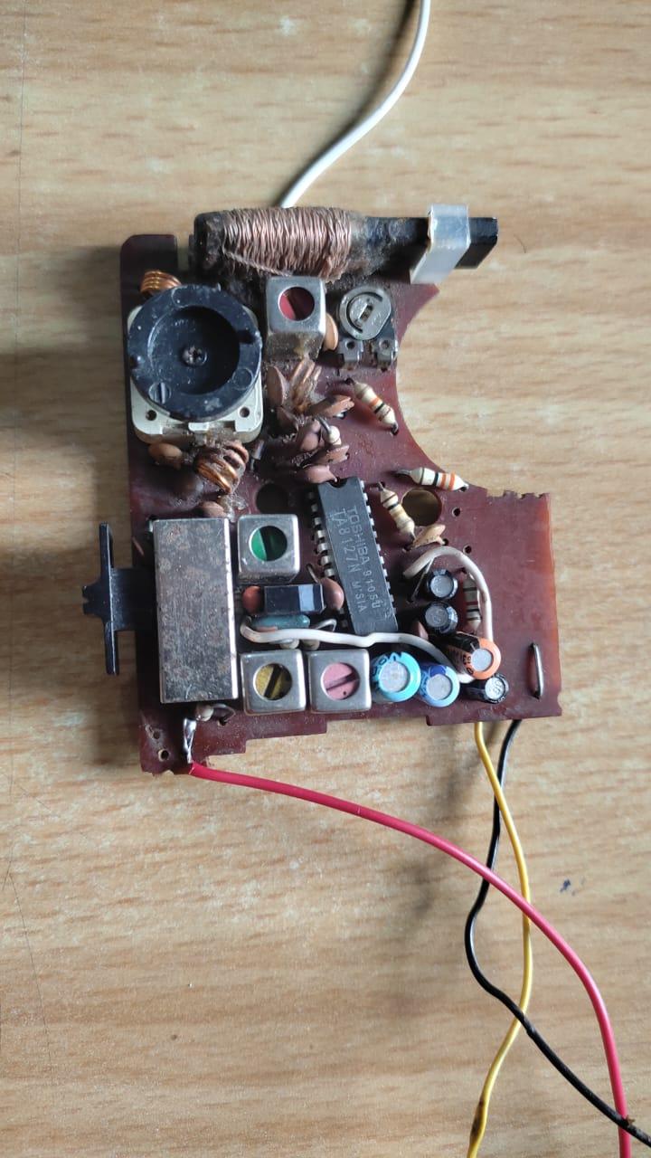

I found an old radio and cassette player circuit from my collection of old circuits. This circuit consists of three different ICs i.e. TA8127N which is an stereo AM/FM superheterodyne receiver chip. second is TA8119 Which is an Stereo cassette playback pre amplifier and equalizer. The last IC is KA2402 which is used to control the speed of motor of the cassette player. After observing the circuit, I found that there is no power amplifier section on the circuit, So I decided to make a low power audio power amplifier so that we can test the circuit. For this separated the radio section of the PCB by cutting it out by saw. Now I soldered four wires to to the radio PDB.
Red------------> for 6V DC supply
Black----------->for GND
Yellow--------->for audio output
White----------->for FM antenna

Step 1: Cut Out the Radio Section
Cut out the radio part of the circuit carefully using a saw. then solder four wires to the circuit as shown in the fig. for Vcc, GND, audio output and antenna.
