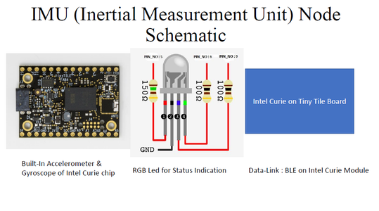

Step 3: IMU (Inertial Measurement Unit) Node
- IMU Node contains all the required hardware such as 3-axis accelerometer, 3-axis gyro and 3-axis magnetometer for a 9-DOF (Degrees of Freedom) Inertial measurement.
- Included GPS can used for aided navigation application.
- Sensor data fusion is employed for gyro drift, accelerometer/GPS error Compensation.
- Depending on the firmware this module can act as :
▪ 6-axis IMU
▪ 3-axis Magnetometer
▪ 66 channel High Accuracy GPS Module with fast TTFT

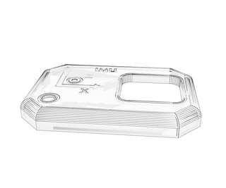

Step 4: IMU Node Fabrication
IMU Node is wired with other sensors on Perf-Board and is Enclosed in the custom 3D Printed Enclosure.
Hot Glue is used for securing all components to the enclosure

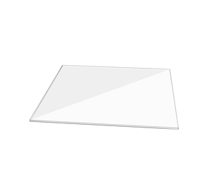

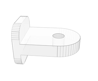

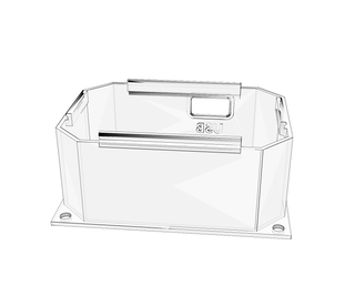

Step 5: IMU Node 3D Design Files
Solid-works software is used to model and design all the parts. All files required for 3D printing is given here.

Step 6: IMU Node 6 Axis Motion Sensor Schematic, Code & Demo
Arduino code is attached & Result of working is Showed on nRF Connect android app from Nordiac Semiconductor ( available on Play store )

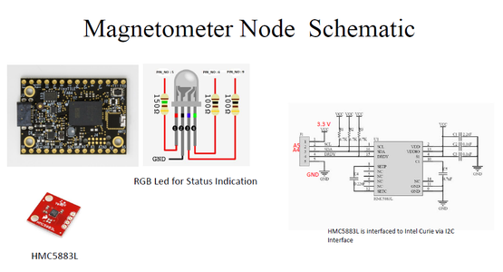

Step 7: 3 Axis Magnetometer Schematic, Code & Demo

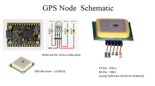

Step 8: GPS Node Demo & Arduino Schematic, Source Code

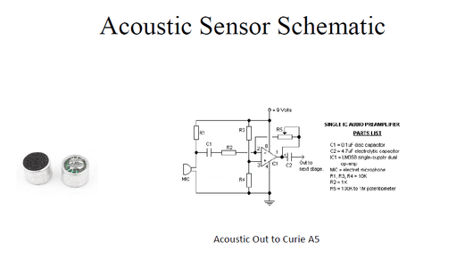

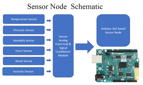

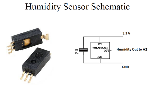

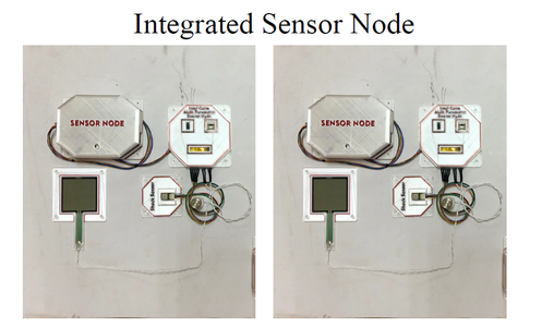

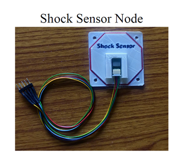

Step 9: Sensor Node
- Sensor Node is built around Arduino 101 BoardIt acts as a scalable multi-parameter monitoring Node

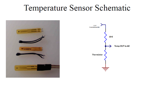

- Basic Node Consists of Pressure, temperature & humidity sensor

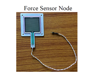

- Basic Node has the capability to attach following sensors:

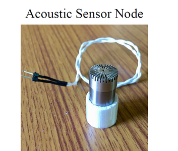

▪ An Acoustic Pick-up sensor

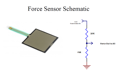

▪ A Strain-gauge based on FSR ( Force Sensitive resistor )
▪ A high precision Shock sensor

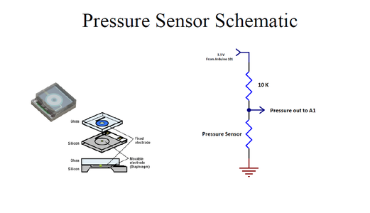

Step 10: Sensor Node Schematics
Schematics & Wiring Diagram of Sensor Node is given here.
Step 11: Sensor Node Demo & Source Code

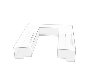

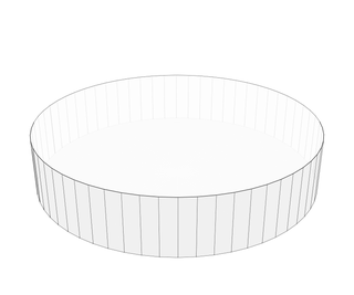

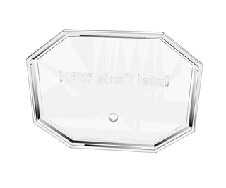

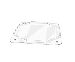

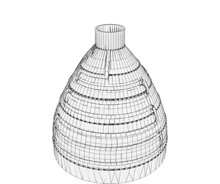

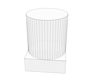

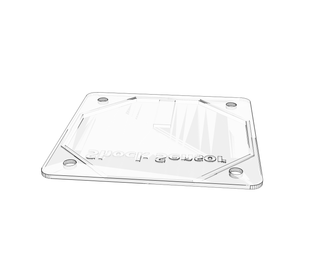

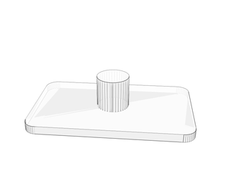

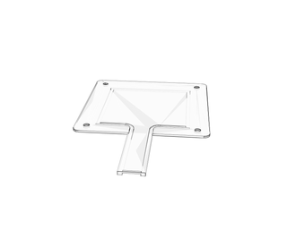

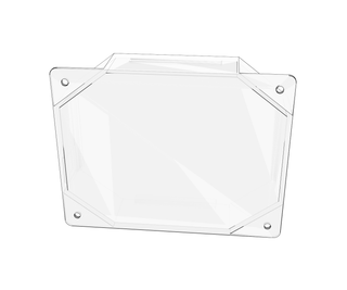

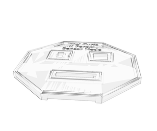

Step 12: Sensor Node 3D Design Files
1) Multi Parameter Sensor Node Base.SLDPRT
2) Multi Parameter Sensor Node Cap.SLDPRT
Multi Parameter Sensor Node Assembly.SLDASM
1) Intel Curie WSN Base.STL
1) Multi Parameter Sensor Node Base.STL
2) Multi Parameter Sensor Node Cap.STL
FSR.SLDPRT
FSR.STL
1) Shock Sensor Base.SLDPRT
2) Shock Sensor Lock.SLDPRT
1) Shock Sensor Base.STL
2) Shock Sensor Lock.STL
1) Intel Curie WSN Base.SLDPRT
Intel Curie WSN Box Assembly.SLDASM
2) Intel Curie WSN Cap.SLDPRT
3) Arduino 101 Rough Model.SLDPRT
2) Intel Curie WSN Cap.STL

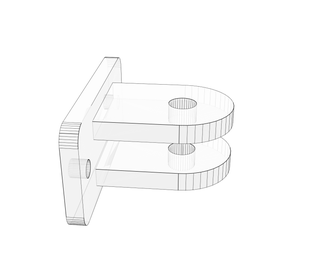

Step 13: Actuator Node
Actuator Node is built around an Arduino-101 with two Servo motor based linear actuators. Both actuators are attached to the Nozzle for Thrust vector Controlling and thus forming an Engine Gimbal Control. Actuator has a BLE Service and its characteristics can be written from central node.
Step 14: Actuator Node Assembly
Different joints and linkages are designed and 3D Printed.
M3 nut & bolt along with washers are used for assembly.
Step 15: Actuator Node Code & Schematic
Schematic & Source-code of actuator node is given here.

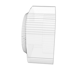

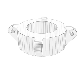

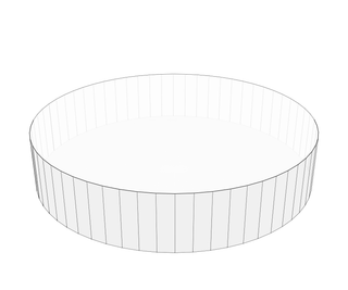

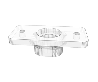

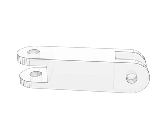

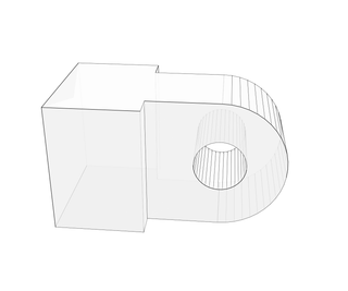

Step 16: Actuator Node 3D Design Files
1) Servo Arm.SLDPRT
1) Servo Arm.STL
2) Servo Arm Extension Bar.STL
2) Servo Arm Extension Bar.SLDPRT

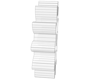

3) Rack.SLDASM
3) Rack.STL
4) Pinion (Spur Gear).SLDASM
4) Pinion (Spur Gear).STL
5) Servo Attachment.SLDPRT
5) Servo Attachment.STL
6) Servo Attachment 2.SLDPRT
6) Servo Attachment 2.STL
7) Servo Attachment 3.SLDPRT
10) Lock for Hinge Attachment 8 & 9.STL
7) Servo Attachment 3.STL
8) Lock for Attachment 6 & 7.SLDPRT
8) Lock for Attachment 6 & 7.STL
Thumbs.db
1) Hinge.STL
2) Hinge Attachment.STL
3) Hinge Attachment 2.STL
4) Hinge Attachment 3.STL
5) Lock for Hinge Attachment 2&3.STL
6) Hinge Attachment 4.STL
7) Hinge Attachment 5.STL
8) Hinge Attachment 6.STL
9) Hinge Attachment 7.STL
1) Hinge.SLDPRT
2) Hinge Attachment.SLDPRT
3) Hinge Attachment 2.SLDPRT
4) Hinge Attachment 3.SLDPRT
5) Lock for Hinge Attachment 2&3.SLDPRT
6) Hinge Attachment 4.SLDPRT
7) Hinge Attachment 5.SLDPRT
8) Hinge Attachment 6.SLDPRT
9) Hinge Attachment 7.SLDPRT
10) Lock for Hinge Attachment 8 & 9.SLDPRT
1) Nozzle.SLDPRT
3) Fix plate.SLDPRT
2) Nozzle Holder.STL
3) Fix plate.STL
1) Nozzle.STL
2) Nozzle Holder.SLDPRT

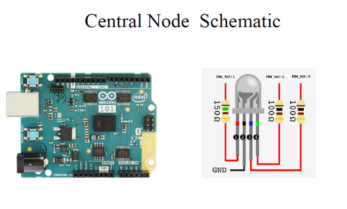

Step 17: Central Node
Central Node handles the task of data acquisition from all sensor nodes and is also responsible for updating the actuator node variables. The Central node also has the capability to analyse the incoming data for any errors.The Nodes work on the concept of publish/subscribe model. Each Sensor node & actuator node has a BLE service and associated characteristics which can be read or written into.All nodes will be in the advertisement mode initially.Central node connects to each nodes sequentially and will read / write the required services & characteristics.
Step 18: Central Node Internals
Central node is for exploring the sensor and actuator node services and characteristics and posting the values to UART link. Source Code & schematic is given here.

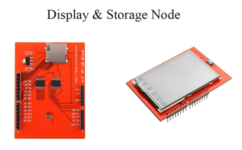

Step 19: Storage & Display Node
Storage & Display Node does the task of receiving the data from central node via a UART link and It stores the data in a micro-SD based card and uses the On-board TFT display to show the parameters and connection status in near real time.
