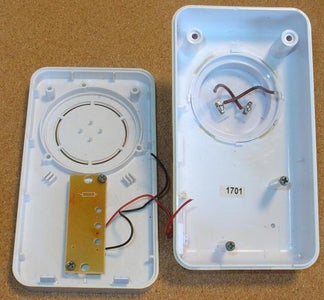

Step 2: Door Bell Push Button Retrofit

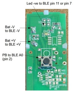

Here the existing doorbell was refitted with a BLE module. The existing doorbell button is stripped of most of it components, except for the battery holder, led and its resistor and the main push button. A small nRF52832 module is then added to broadcast “Front_Door” when the button is pressed.
Before removing the components from the existing door bell push button, the doorbell led and its series resistor was identified and the led polarity determined with a multimeter on diode mode. The led and its series resistor is kept when the other components are removed.
Tracing the track on the doorbell PCB gives the layout below (pdf version) Apart from the battery connections (Bat -v and Bat +v) there are only two other connections. One from the push button to nRF25832 pin 2 (A0). The push button connects to the +V when pressed. The other is the output to drive the led indication when the button is pushed. The +ve side of the led is connected to Bat +v, on the pcb, via a series resistor. The negative side of the led is connected to the ble module, either pin 7 or pin 11 as convenient.
In this construction a PCB from the BLE Window Open Detector was used trimmed to fit and pin 11 was used to drive the led. However you can also a piece of veroboard to mount a YJ-16013-NRF52832 module and use pin 7 to drive the led.
Here is the completed bell button PCB wiring (last photo above). Note that the tracks at the bottom of the original push button board have been scrapped off so as not to interfere with the BLE module's antenna,

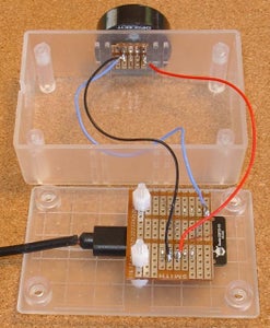

A Safe Low Voltage Monitor for Beginners
The low voltage monitor consists of just an Dfrobot Beetle ESP32-C3 and an MP3 speaker (shown here) or buzzer, powered by a USB supply. The MP3 speaker pins pass through holes in the plastic case and a small piece of veroboard is soldered to the MP3 speaker pins to secure the speaker in place.
Again the circuit is trivial (pdf version)
If using a buzzer instead of the mp3 voice module, then connect the buzzer between pin 6 and GND. The Dfrobot Beetle ESP32-C3 has a built-in led on pin10 which is used as the indicator.

The speaker and main pcb of the existing receiver are removed. The led board is kept and an 820R resistor added in series with the led so it can be driven by Pin 4 of the Dfrobot Beetle ESP32-C3.
To power the receiver, the power board from a USB supply was used an its mains power leads wired to the power pins of the in the receiver case.
A piece of veroboard is used to mount MP3 speaker and USB supply board and the Dfrobot Beetle ESP32-C3 board in the original case. The modified led board is used as the indicator led.

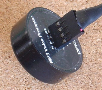

Step 6: Recording Your Doorbell Tune
Before wiring up the MP3 speaker, load it with the tune .mp3 file you want played when it the door bell is pressed. As delivered the Voice Prompt Module has two files. Plug in the USB cable (supplied with the speaker) as shown here. NOTE Carefully: the red lead goes to the 5V pin and the silver side of the plug faces the 5V... GND labels.
The MP3 speaker will appear as a disk drive on your computer. Delete the two .mp3 files and copy your tune as 001.mp3. An example prompt file is here(See the next section for how to make your own.)
To test the tune touch the P1 pin to the GND lead.
Once you have loaded your tune and tested it, you can wire it into the board. Be very careful when wiring up the Voice Prompt module to correctly connect the 5V and GND pins.

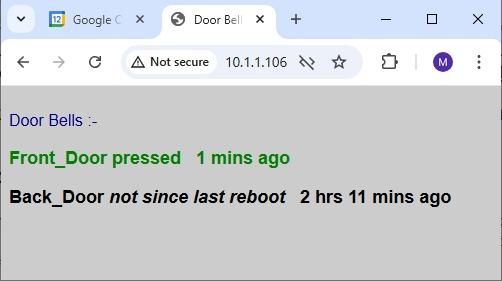

Open the monitor's webpage http://10.1.1.106 for example if you set 10.1.1.106 as the monitor's IP and you will see a list of the door bells being scanned for and when they were last seen.
The DoorBell_ESP32C_Monitor_Server sketch scans for the expected BLE devices. When one is seen the time is recorded and the tune or buzzer is sounded and the led is set to flash slowly. When you return after being out, if the led is flashing slowly you know the door bell was pressed while you were away. You can then open the monitor's webpage to see which button was pressed and how long ago. Opening the monitor's web page also turns off the flashing led.
When a door bell is pressed the monitor's led starts flashing slowly. When you open the web page it cancels the flashing, so close the webpage after checking.
