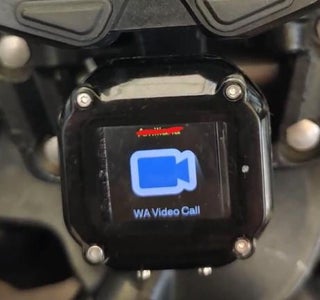

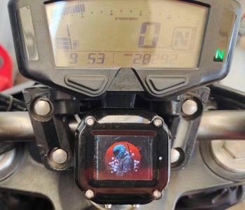

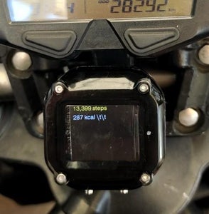

When we ride a motorbike, sometimes we are disturbed by some notifications, or when we listen to directions from Google maps we forget the directions, or maybe when a call comes in, we hesitate to pick it up or leave it because we don't know who is calling us.

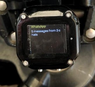

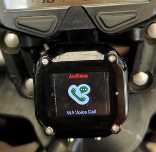

The core idea of this device is actually forwarding all notifications that appear on your Android to a 1.3-inch color TFT screen, using Bluetooth wireless communication (BLE).
what you need is as follows :

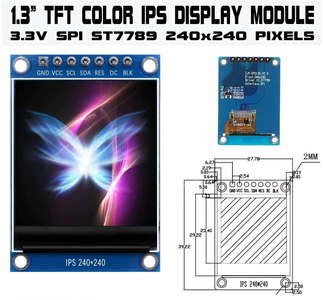

  1. 1 x 1,3-inch SPI TFT display ST7798

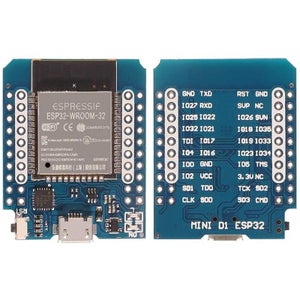

  2. 1 x Wemos ESP32 Mini
  3. Some cables as needed
  4. Case for mounting on the motorbike

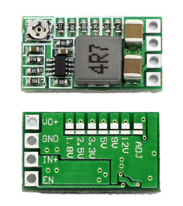

  5. DC Step-down Buck Converter 3A
  • I use ST7798 because it's easy and it has a fast refresh rate

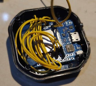

  • Wemos ESP32 Mini has a small size, so it will fit in my case
  • use a small cable so it fits in the case
  • I use, a used motorcycle TPMS case for it because it's waterproof and strong enough
  • Voltage regulator from 12v/24v to 5v for powering your ESP32 and Display

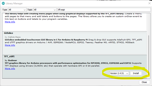

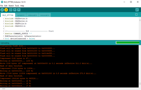

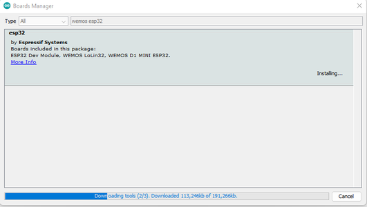

Step 1: Preparing Your Arduino IDE
  1. Install Wemos D1 Mini ESP32 Board from the board manager or download it from here

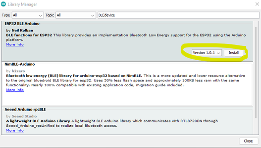

  2. Install ESP32 BLE Arduino from the Library manager or download it from here
  3. Install TFT_eSPI from the Library manager or download it from here

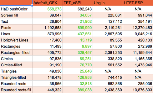

why did I choose ST7798 and TFT_eSPI library?
this is purely due to the excellent speed that can be provided from this combination, other than that this display is easy to obtain in the market.
indeed the configuration of the TFT_eSPI library is more complicated than usual, but it will not be a problem when we get extraordinary results

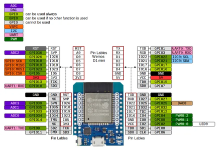

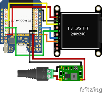

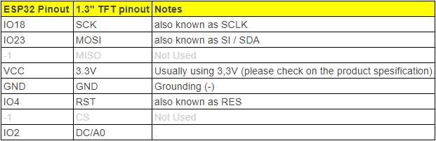

Step 3: Assembling the Electronic Parts
  • After we set up our TFT_eSPI library as in step 2, we will get the configuration above.
  • connect the TFT Display to the ESP32 board as follow and power it using a 5V 3A regulator from the 12V motorcycle ACCU.

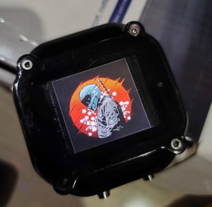

Step 6: Ready to Use
  1. Turn on the ESP BLE client
  2. Run the Android Apps
  3. For the first time, Allow all the permission
  4. Click Listen service button and allow access to the Notification for Notification_BLE
  5. back to the apps and you can click Connect and start using it, all notifications from your Android will appear in the display

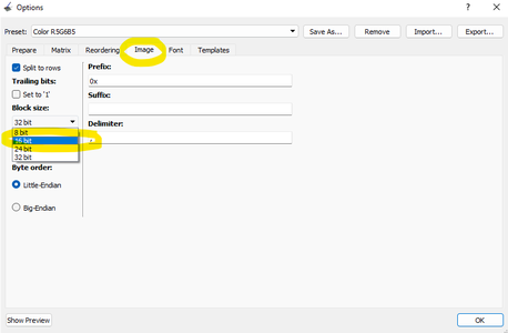

Step 7: Bonus Step - Change the Image

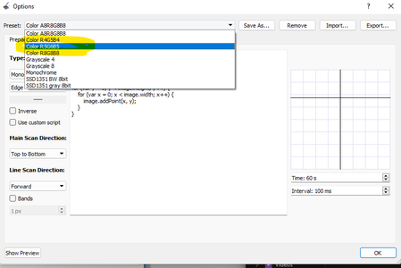

In this project I use 240p x 240p 72DPI image for all icons, if you want to change it can use LCD-Image-converter to replace the code.
  1. create an image 240p x 240p 72DPI
  2. Open the image using LCD-image-converter
  3. click Options --> Conversion...
  4. Choose Color R5G6B5 from the Preset dropdown menu
  5. Click the Image tab and choose 16 bit from Block size dropdown menu
  6. Click Show Preview and you can copy that code and paste it on the image file library.
