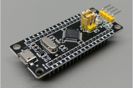

  1. STM 32 BOARD

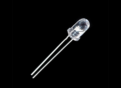

  3. LED

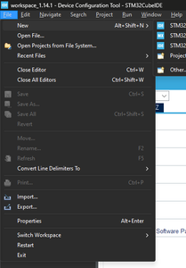

Step 2: STARTING THE PROJECT
As we head into programming in the CUBE IDE head over to the top left and create a new STM32 project by clicking on "FILE" and then "NEW" then after on new "STM32 Project"

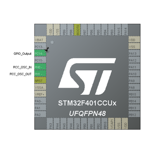

Step 3: SETTING PIN CONFIGURATION
Once the file is created select the required STM board and then after set the pin configuration as shown.
Here, basically we set pin C14 as our required pin.
NOTE: Set the pin in output configuration as we will be writing the data i.e. we will be giving the input through the code.

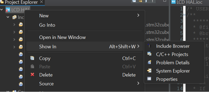

Step 6: Using the Binary File
One of the tricky part is that we will require the binary file i.e. .elf file.
For that, we simply open the .elf file created in the system explorer by Right clicking on the project and clicking on show in system explorer and copying the path on the STM32Cube PROGRAMMER.

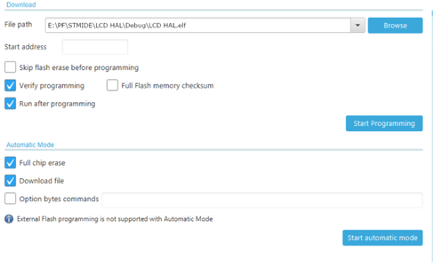

Step 7: STM 32 CubeProgrammer
Next we just need to copy the path of the file in the programmer connect the STM32 Board with the system and upload the code to get the required results.
In the hardware connections make sure to connect the pin C14 with the positive terminal of the LED and the GND pin of the board with the negative terminal of the LED.
