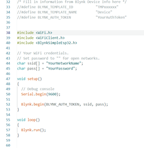

Step 3: Work With Arduino
Arduino IDE:
  1. New Sketch > Tools > Library manager > BLYNK (Search)
  2. Blynk by Volodymyr Shymanskuy > Install
  3. Go to Blynk > Click to copy code
  4. Code: [ Blynk_TemplateID "_"
Blynk_Template_Name "_"
Blynk with token ID "_" ]
  1. Go to Arduino IDE > File > Example > Blynk Wifi > ESP32 Wifi
  2. It will open another file -> You will see the code
  3. In line 33 (of code) > Paste the link that copied from dashboard
  4. In line 43 (of code) > Write your 'Wifi-Name' in "SSid"
  5. In line 44 (of code) > Write 'Password of Wifi' in "Pass"
[ SSid > Wifi Name
Pass > Wifi Passsword ]
  1. Select board & COM > ESP32 Dev Module
  2. Upload > Done uploading
  3. Serial Monitor (open) > (As we have already done with the connection)
  4. Press the 'Restart' button on the ESP32 (EN Button)
  5. When Serial Monitor shows "Start"
  6. Restart the "Wi-Fi"
  7. Now Serial Monitor show "Connected to Wi-Fi"
  8. System Is Ready (close Arduino IDE)
  9. Go to Blynk > Now ON & OFF the LED from the Switch
