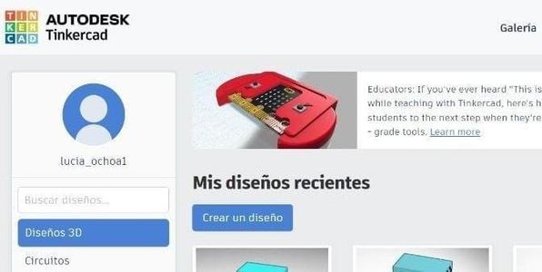

Step 1: We Start
To start designing our BMO in Tinkercad Autodesk, we go to the page and in our main window we select the option of ´´Create a design´´.
Now we visualize the main board.

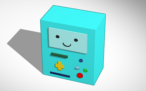

Step 2: Body
The first thing will be to create the body so that we will need a cube , to adapt it to the measures .
Now to create it, we will head to the bottom right corner and basic shapes, select the cube and drag it to our board.
For your body configurations, there are three important sizes , the width , the length , the height and these will be your measurements.
Width: 40 mm
Length: 50 mm
Height: 70 mm
Step 3: Colour
Then we will edit the color of our project so that we select the cube and we go towards ´´solids´´  , after to ´´predefined values´´ and select the color that we like the most , in this case light green.
Step 4: Face
It is time to create the face of our project , so we will follow the same as step 2 and 3 , only with different measures and color , in this case will be :
Width: 20 mm
Length: 40 mm
Height: 20 mm
For the color we will only change it to light blue.
Before finishing we will edit its position for that we use this arrow where it will allow us to raise and lower the cube at the same time that selecting the cube we move it according to the predetermined distance.
Remember to always group, as it will help us so that the pieces do not move from the position in which they are, for this we select the whole project and we clik the option to ´´group´´ at the top.
Step 5: Details
It’s time to start with the details of our BMO, we will do 8 details in total.
1. We select a cube, we put these measures : 18mm x 2.70mm x 2mm , the color is green, we accommodate it in the upper left.
2. We select a pyramide, we put these measurements: 4.50mm x 3mm x 4.30mm , the color is yellow, we put it in the bottom right
3. We select a sphere, we put these measurements : 4.50mm x 3.50mm x 3.90mm , the color is light green , we arranged it on the top bottom to the side of the pyramid .
4. We select a sphere, we put these measurements : 6.30mm x 2.80mm x 5.90mm , the color is red , we put it in the bottom right , below the details 2 and 3.
Step 6: More Ditails
5. We select one hectare , we put these measurements : 3.61mm x 1.40mm x 3.40mm , the color is blue , we put it in the upper right.
6. We select a cube, we put these measures : 5mm x 4mm x 9mm , as we are going to form a cross , we copy one of these cubes and move it 90 degrees , then we put them together so that it remains in the form of a cross , in the most perfect way and we group it as we teach in step 4 , we arrange it in the bottom right under the 1 detail.
7-8. We select a cube, we put these measures : 11mm x 8mm x 1,70mm , the color is blue , as there are two , we simply copy and accommodate them in the bottom right under the detail 6.
Step 7: Parts of the Face
We are almost finished! , we will make the parts of the face that are 3
1-2. For the eyes, we choose a sphere , we put these measurements : 3.48mm x 2.48mm x 3mm , the color is black , we rotate it in 90 degrees , we copy so we will have two eyes and we accommodate them at the top of the face.
2. To make the mouth, select a ring and drag it to the board, then select a cube ,this will be in ´´Empty´´ this option is usually used to cut a shape , we place it on top of the ring and put the grouping option , as the mouth is formed , now we rotate it in 180 degrees , the color is black and we accommodate it at the bottom of the face.
