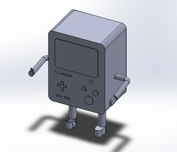

Step 1: Create Your 3D Printed Parts
First, you'll need a 3D design software like Inventor or Solidworks. I am more familiar with Solidworks so I used that program for my project.
Body:
I chose to make BMO's body 125x90160mm. Don't forget to round the corners of his body as well. Then, I made a hole for the left leg 16mm in diameter and two holes for the arms 11mm in diamter.
Legs and feet:
His legs are both 15mm for their outer diameter and 14mm for their inner diameter because the legs are hollow. His feet are slots with a radius of 7.5 mm and a length of 15mm from one radius to another. You then cut the top half of the left foot only up until the second radius so you can grab the candy that fall out of the leg.
Arms and hands:
Next, the arms are both hollow with am inner radius of 9mm and an outer radius of 10mm. His shoulder to elbow is 40mm while his elbow to wrist is 50mm in length. The curved elbow has a center distance of 11.3mm. His hands have a 8.5mm peg that you insert into the wrist. Aside from that I created a peace sign for his right hand and a normal hand for his left side.

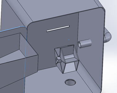

Wheel:
The wheel is actually a pentagon. I started with drawing a cylinder with a 5.5mm radius and 20mm in height. From there I drew a 1x15mm rectangle from the perimeter of the circle protruding straight outwards. I used the circular pattern feature to create four more of these rectangles evenly spaced about my cylinder. Then I used boss extrude at 20mm. Then I used the feature "rib" to make the walls of the wheel 1mm thick. I cut out a rectangle right in the middle of the cylinder 5.5x7mm in size. This is so the wheel is able to be attached to the step motor. The hollow cylinder that holds and dispenses that candy to the wheel is the same measurements as the legs.
Make sure to save your part files as a .STL file for 3D printing purposes.
