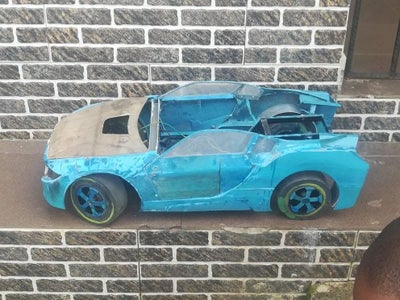

In this project, I’ll show you how I built a remote-controlled BMW i8 replica using PVC pipes, recycled plastic, and other locally sourced materials. Inspired by the sleek design of the real i8, I wanted to challenge myself to recreate its futuristic look using affordable and accessible components.
This build combines creativity, engineering, and resourcefulness—perfect for students, hobbyists, or anyone passionate about DIY RC cars. Whether you're in a workshop or working from your backyard, this guide proves that innovation doesn’t need expensive tools—just imagination and determination.
Follow along as I walk you through the design, assembly, and test run of this custom RC supercar. Let’s build something extraordinary from the ordinary.

Measure and Cut: I measured the base dimensions of the BMW i8 design I wanted to replicate, then cut the PVC pipes accordingly. The frame was roughly 72cm long and 31cm wide.
Assemble the Rectangle Base: Using the cut PVC pieces, I formed a rectangular base. I glued the corners together using hot glue and reinforced them with PVC cement for extra strength.
Add Cross Supports: To make the frame sturdy, I added two crossbars in the middle. These help support the motor, battery, and electronics later on.
Check for Alignment: I placed the wheels temporarily to check if everything was aligned properly. This step is important to ensure smooth movement later.
Let It Dry: I allowed the glue to dry completely before moving on to the next step. This ensures the frame won’t shift or break under pressure.
Tip: If you don’t have PVC cement, hot glue works fine for lightweight builds. Just make sure to reinforce the joints.
