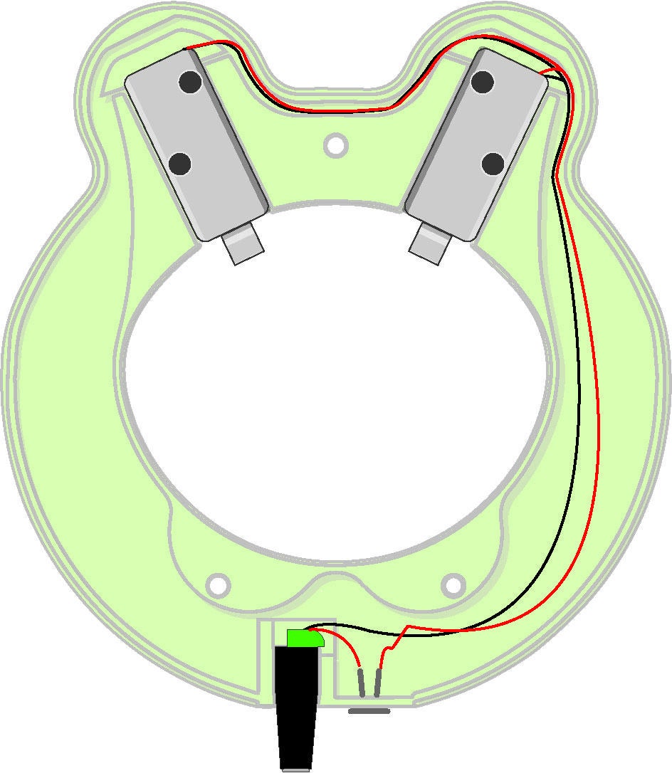

Step 14: Electronic Step 1:
conect the head connector to the slide 10 cm after the edge.
Note that the holes are in the right direction!
Step 15: Electronic Step 2:
Insert the electronics into the shell as shown in the image
Step 16: Electronic Step 3:
Close with the lid and lock with the screws and nuts.
After locking, insert the wooden dowels into the lower holes
Step 17: Electronic Step 3:
Connect the head
Step 18: It's Ready
Done!
