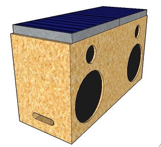

Step 2: Build the Cabinet and Install the Electronics, a Step-by-step Guide

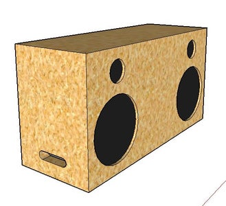

Cut all the different panels that are needed to build the kabinet. I have given the different panels letters, so it is easier to describe the assembly process. The cabinet is made form 12mm plywood.
• 2 pcs A - 772mm x 276mm (Bottom/Top)
• 2 pcs B - 796mm x 417mm (Fronts)
• B1 - 300mm x 417mm
• B2 - 300mm x 417mm
• B3 - 196mm x 417mm
• 2 pcs C - 276mm x 417mm (Sides)
• 4 pcs D - 393mm x 276mm (Speaker bracers)
• 1 pcs E - 196mm x 276mm (Electronics compartment bottom)

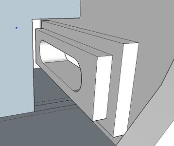

• 2 pcs F - 180mm x 70mm (Handle/bass reflex 1)
• 2 pcs G - 160mm x 50mm (Handle/bass reflex 2)
• 2 pcs H - 393mm x 276mm (compartment sides)
The big hole down the middle of panel B (named B3 later) in the sketchup file is ment to be a door, so electronics can be accessed once the build is complete.
NOTE: All joints should be sealed. I used wood glue for this.

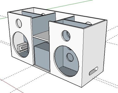

1. Cut on of the B panels in to three sections B1, B2 and B3.
2. Cut holes for the woofers and tweeters in B, B1 and B2, as showed in the sketcup file.
3. Cut holes in C, F and G as shown in the sketchup file. These hole make handles/bass reflex and are vital to the design.
4. Glue panel C, F and G together(one of each, for each side). Since they will not hold anything, screws should not be necessary.
5. Paint panels A, B and C. (optional, but i recommend it, so it keeps moisture out of the wood)

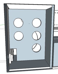

6. Cut holes in H and E panel for routing wires through. Preferably as small holes as possible, 15mm-20mm should be more than enough.
7. Mount woofers and tweeters in B, make sure to leave speaker terminals turning upwards. Seal the edges around the speakers and screws with acrylic sealant. Reinforce the tweeter with it aswell, this is done by adding some to the creases on the back of the tweeter.
8. Cut holes and cut-ins D panels, as shown in the shetchup file.

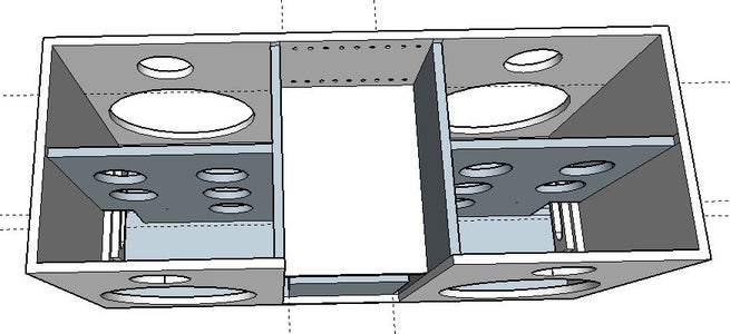

9. Assemble one A panel and B1 and B2, as shown in the shetchup file. Start with the A that will be the bottom.
10. Assemble both C and H panels to the part from step 9, as shown in the sketchup.
11. Mount the D panels, as shown in the sketcup file. NOTE: The D panels should be glued to the woofers when they get mounted. I used a two component epoxy glue for this.
12. Mount the B panel, and remember to glue the woofers to the D panels.

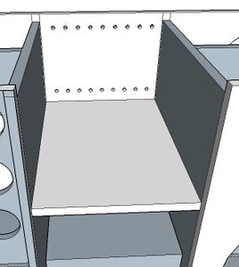

13. Mount E panel. The placement of of this panel is up to you, and how much room you need for the batteries. The batteries go below the panel.
14. Route wires to the speakers through the holes in each H panel, and connect them to the speakers according to the wiring diagram.
15. Route wires from the batteries through the hole in E panel and connect batteries.
16. Mount solar panels on the last A panel. Make sure to cut holes so you can route the wires from them internally.
17. Make sure your wires from speakers, batteries and solar panels are long enough to reach everything that needs to be connected.
18. Mount the last A panel.
19. Connect all electronics according to wiring diagram.
20. Seal wire routing holes in H panels, you can also do it in E panel, but it is not necessary. I used acrylic sealant here aswell.
21. Mount B3 panel with a pair of hinges and a locking mechanism.
22. DONE!
